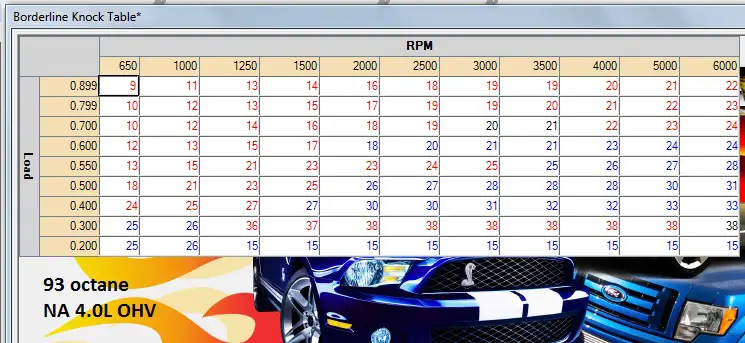

Here's a value file Borderline Knock Table for an Explorer with NA 4.0L OHV running 93 octane race fuel.
Awesome! !!
Now is this total timing or this still need to be added to the base line of 10*
I assume the load is what it sounds like..like wot pull would be pulling a .899 load??

That would be on top of the 10 base.
So here is an attempt at explaining the different spark tables,
The MBT table is just a place keeper or information in the tune, has no effect on where timing actually is.
There is another table called Max Allowed, it is as it seems. It is the max that the pcm would allow under any condition, it wont let it go over this.
The Borderline knock table is where the vehicle will usually run, it is set up for what ever gas the manufacturer recommends. You may see actual timing below that due to knock sensor or IAT temps etc.
So the table above is for 93 octane fuel on a N/A engine, it would not be the stock table. If you can reach this point with boost and 11:1 compression, that would be amazing. Intercooler,Watermeth, and high octane fuels are what is needed.
