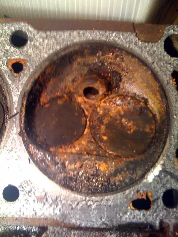

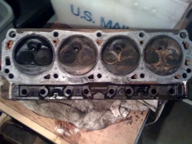

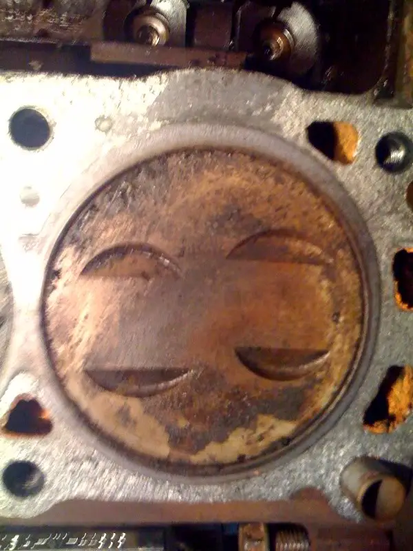

whoever had this engine before did NOT know how to take care of it!
the pictures speak for themselves...
And here is the piston that matches that combustion chamber

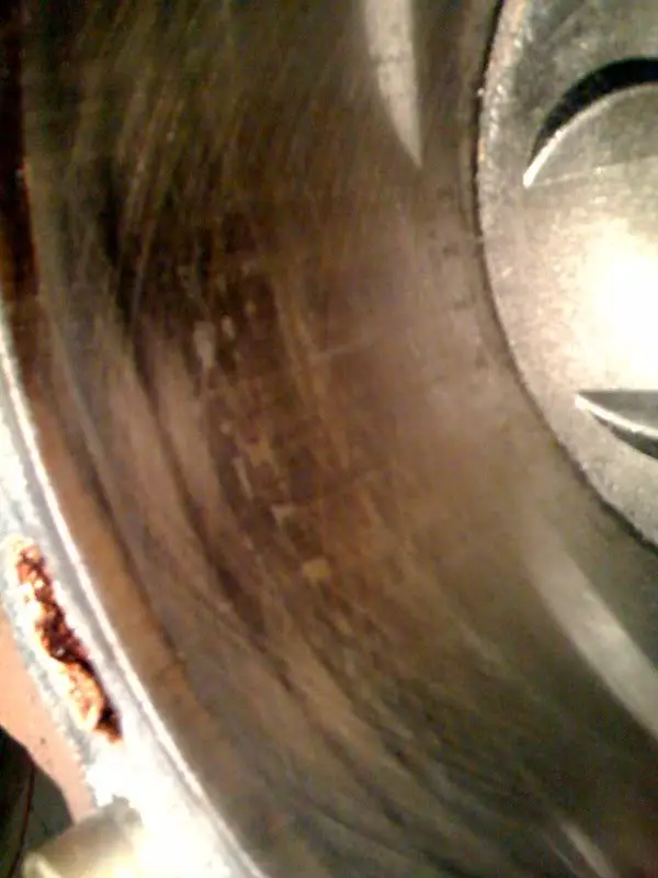

Do these look like honing marks to anyone else? perhaps this engine has been rebuilt?
Just out of curiosity, does this look overly varnished to anyone? im not sure.

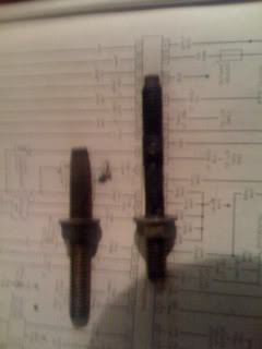

Damn intake bolts! ill just leave it at this, these two bolts are SUPPOSED to be the same length! and the rest of its still in the engine.

that's what I'm hoping. Don't want it to be rebuilt.

now that you ask I think that bolt was the closest one to the front left cylinder(the rusty one).
Must have been a water jacket gasket failure.

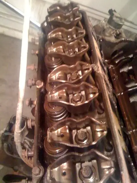

well i always wanted to see a video of the valve train in action, soooooooooooo
i made one!!
Valve train in motion!
sorry im a dummy and i have no idea how to imbed the file.
the best part is near the end when i hold the camera looking down the right bank.
and i love the popping noise that its making!
Dude, that's awesome! If you could get it clear enough and loud enough, it'd be a funny ringtone to have.
Who was cranking it around?
I see what you mean, those noises sound totally weird/cool at the same time.

That's interesting. Now try it once more after the plugs are back in it LOL.
tcha! If I want to break my back.
Doubt my dad would volunteer to turn it again.

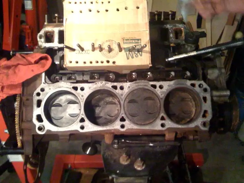

heres as far as i got tonight.
my "workbench" (half a door layn(sp?) over some other crap) is becoming slightly "crowded".

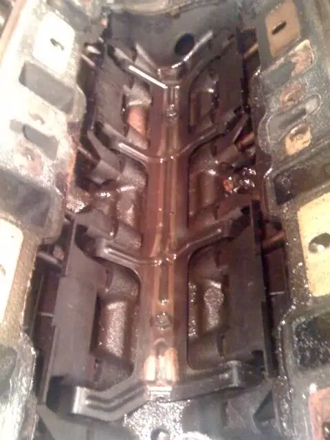

this is what the water jacket insidse the block looks like. the heads look the same!!!!!
Idiot must have run straight water through this thing! WTF?!?
stupid people are everywhere.
and they're BREEDING.

Very good. Find a box of zip lock bags, those work great to keep all of the various bolts apart but together. Check over the bolts you have and keep track of what needs to be replaced. The water pump bolts are easily worn out or broken when they come out of a used engine. Don't reuse any of the exhaust manifold bolts, they don't last long before being too corroded. The lower intake bolts are sometimes like that also. You can tell the good bolts from the bad, just work on replacing the worst of them. Regards,

how should i remove the pistons? My dad says to remove the crank and then pull the pistons out through the bottom of the block.
Edit: nevermind you can't pull the pistons out through the bottom.
