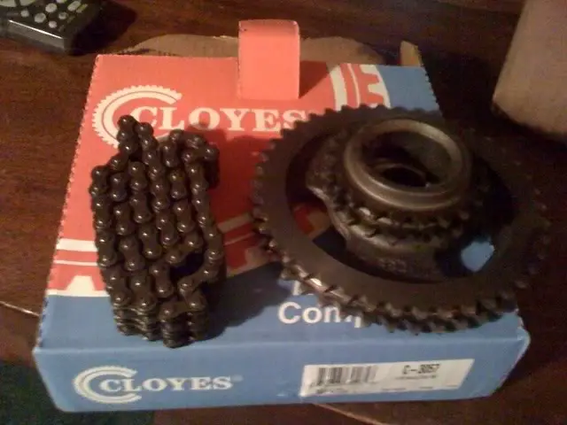

Cloyes heavy duty double roller.
That's good, but are the rollers seamless? That's a key with a roller timing chain.
I bought a Cloyes for my Cleveland about 25 years ago, they were the highest cost, yet had seamed rollers. I was not impressed, I haven't bought a Cloyes part since then. False advertising bothers me.

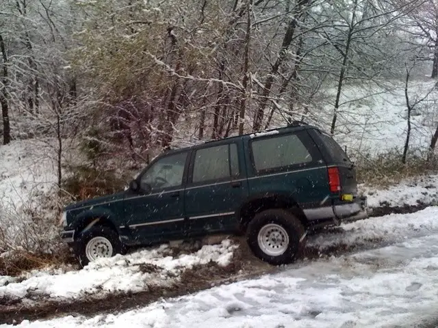

this is why you dont let your late teens daughter take the rear wheel drive mustang for a saturday drive after 5" of snow have come down in 6 hours.
cause shes gonna do something stupid like get stuck halfway up a fairly shallow hill and decide it will be a great idea to PARK the car SIDEWAYS in the middle of the road instead of reversing down the hill and trying again, which will force other people who came prepared with the right kind of car for the weather to swerve into the ditch to avoid her. and get stuck.
but oh well. not like ive never done anything stupid. bad weather, stuff happens.
truck body is fine, drives fine, ill check underneath tomorrow when it warms up.

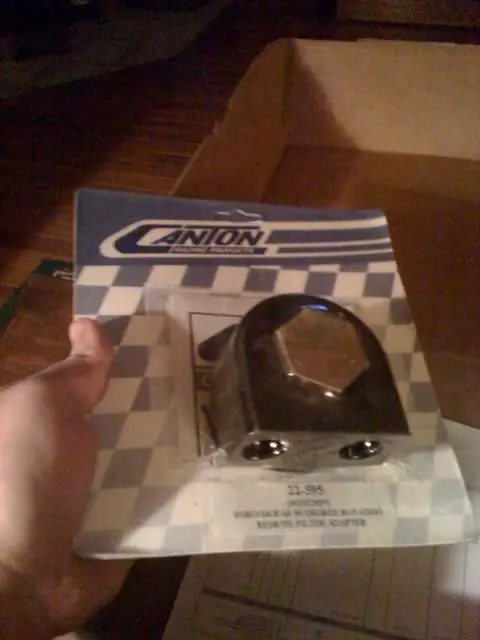

got in the canton adapter from summit and a new oxy-cetylene torch set.

Agreed that you and the truck are fortunate. A little speed or a rut/stump and it could be on its side. Bad drivers are everywhere, people do not think while driving, that's not a requirement.
