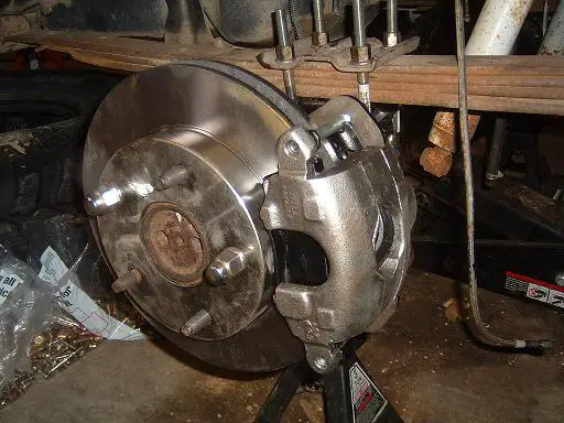

Well it has been awhile sence I updated, I admit I am not very good on taking pictures of everything along the way. At this point I have the 9" fully assembled under the truck mounted. I installed 5.14 gears, and a full spool. I converted the drum brakes to disc brakes. I still need to run hard lines to the brake hoses and buy and mount shocks for the rear.

Here is a pic of the disc brakes installed.
