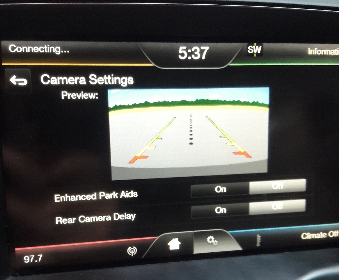

Is My.. 3.10 Update In Camera Setting Fixed Guideline Is Gone??? Always On
Are you saying that after updating to V3.10 that your guidelines are gone? If, so, have you checked your camera settings?
Nop
I Say Setting In 3.08 I Have Option To Enable o Disable Guideline Fixed In 3.10 This Option Is Gone Guideline Fixed Always Active
3.10
3.08
Nop
3.10
3.08
Okay, I understand. I don't think that is a problem. I don't think anyone else has mentioned it. Is your Camera Delay also set to ON? Hard to tell. I have my 'Delay' set to ON as I like that better.
Peter
Peter
Oks Let Me Set On :thumbsup:
