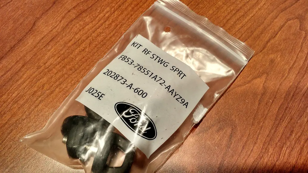

I've been reading my 2016 Explorer owners manual from cover to cover and discovered how to use the new flush roof racks to tie-down light loads. The section is called ROOF RACKS AND LOAD CARRIERS and it starts on Page 234 of the manual. Then on page 235, the manual says:
"A thumbwheel kit is included in your vehicle for tying light loads to your roof. The kit is located in the glovebox."
Problem is, the thumbwheel kit was not included with my Explorer. I sent an e-mail message to my salesman to report the missing thumbwheels, and he was kind enough to give me a thumbwheel kit that he found in the driver-side door compartment of an in-stock 2016 Explorer at the dealership.
If you're the proud owner of a 2016 Explorer, make sure you have a thumbwheel kit in the glovebox as promised in the owners manual. This is what it looks like:
