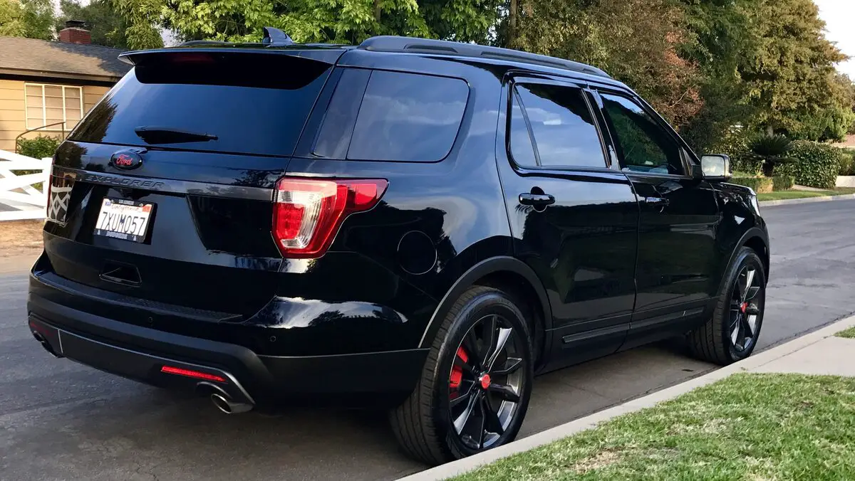

My XLT...
Livernois tune, Pedal Commander throttle enhancer, MGP caliper covers, red wheel center caps, red/black emblems, rear bumper protector, Husky Liners cargo area liner, LED puddle lights.

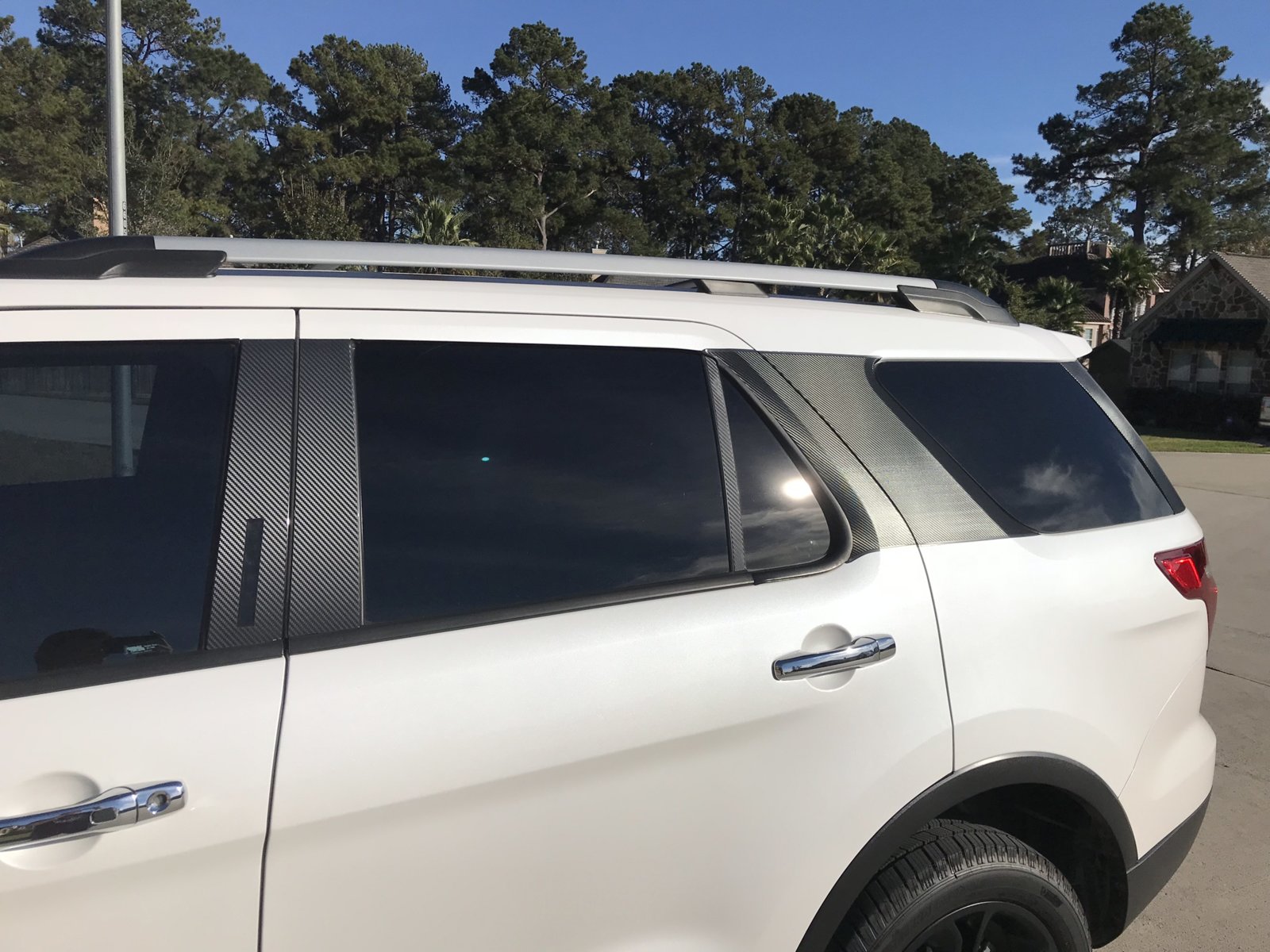

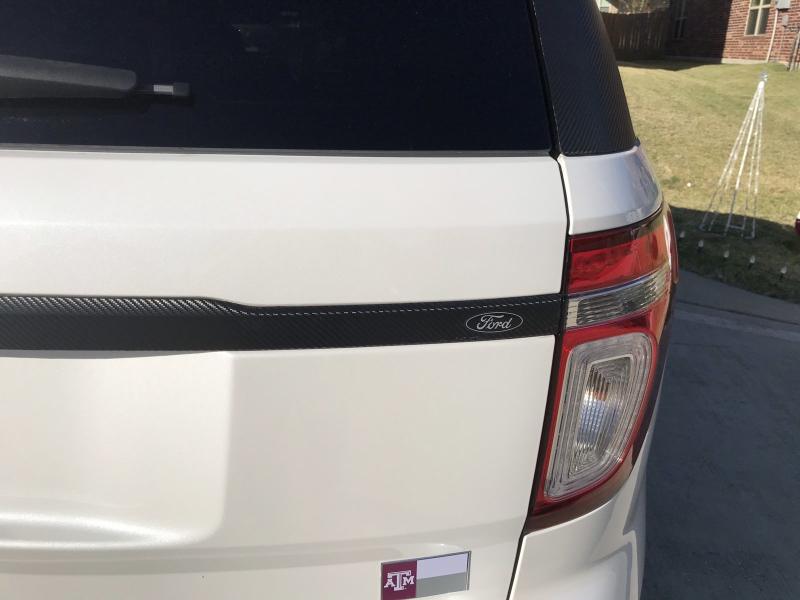

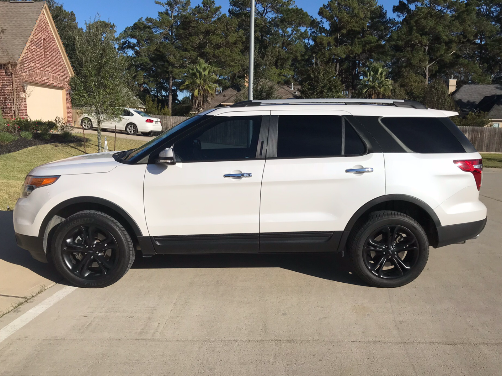

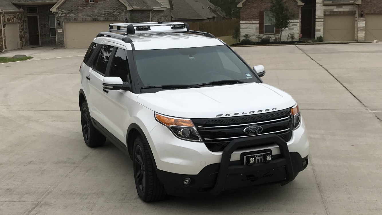

Sometime the cosmetic things have to be created by user I haven’t really seen anything just terribly sic. The ex is not really a sporty statement vehicle like others. So you kind of have to make vision of your own...like mine. Not blue like yours but it can get the idea across. I have the same intake. Noisey *******. But throttle raps quickly with it. I think I am gonna make a cold air box for it to see if it will quiet down some. And the exhaust is coming soon too. At some point the n/a 3.5 just wont be a performance monster the eco boost sport models are, but they aren’t as wimpy as some think they are.
