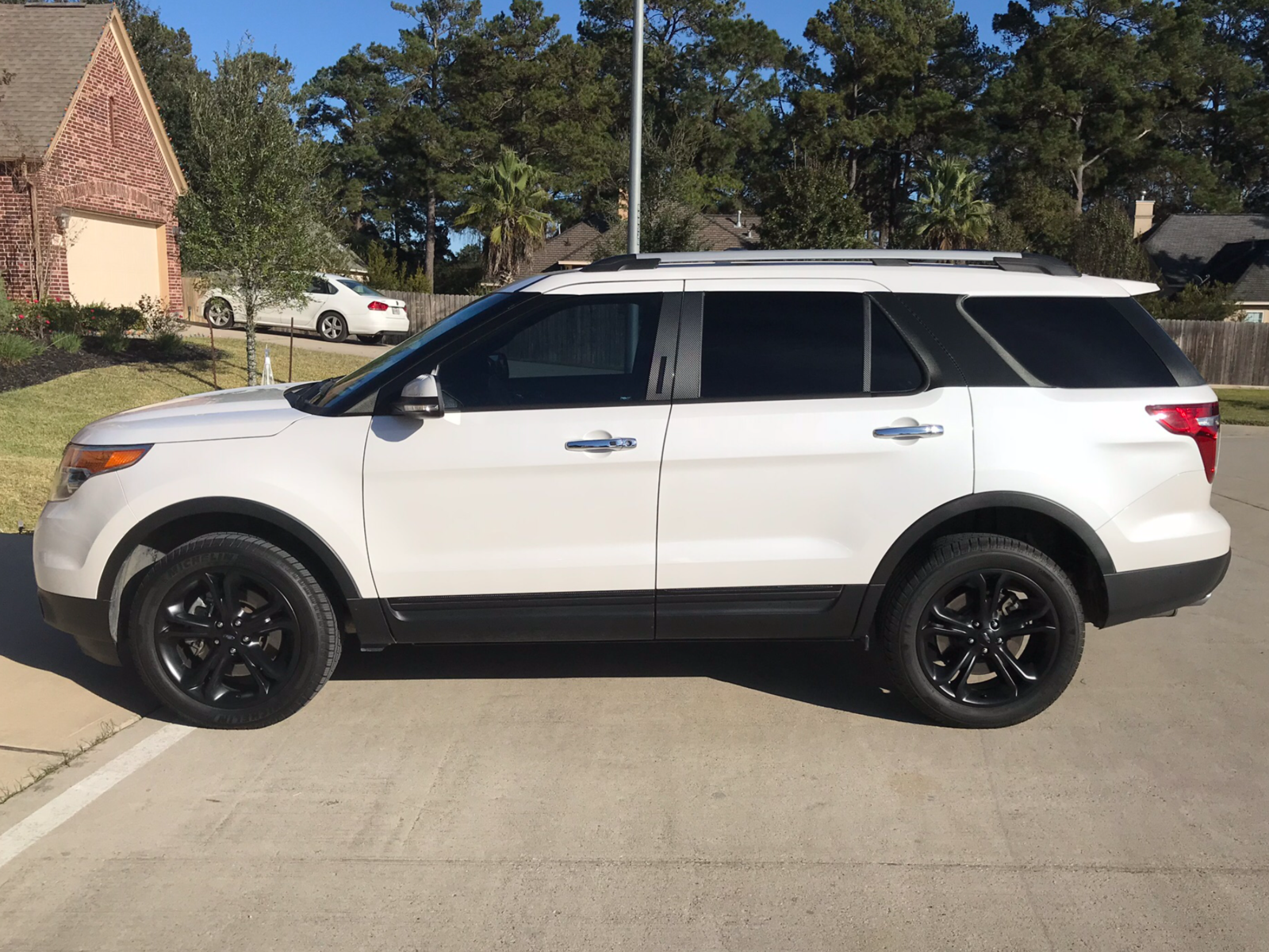

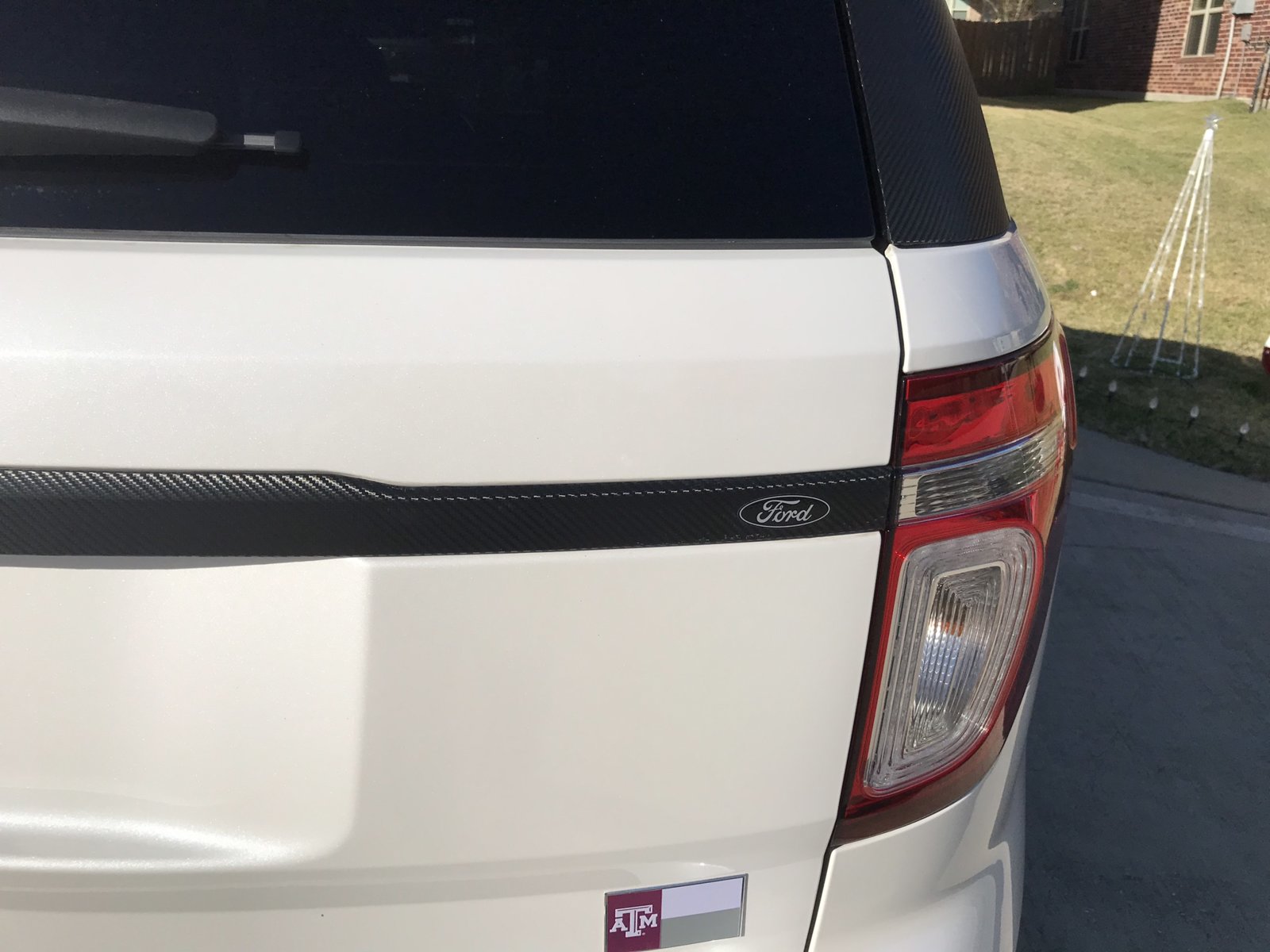

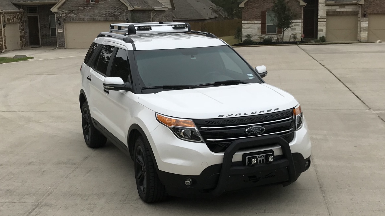

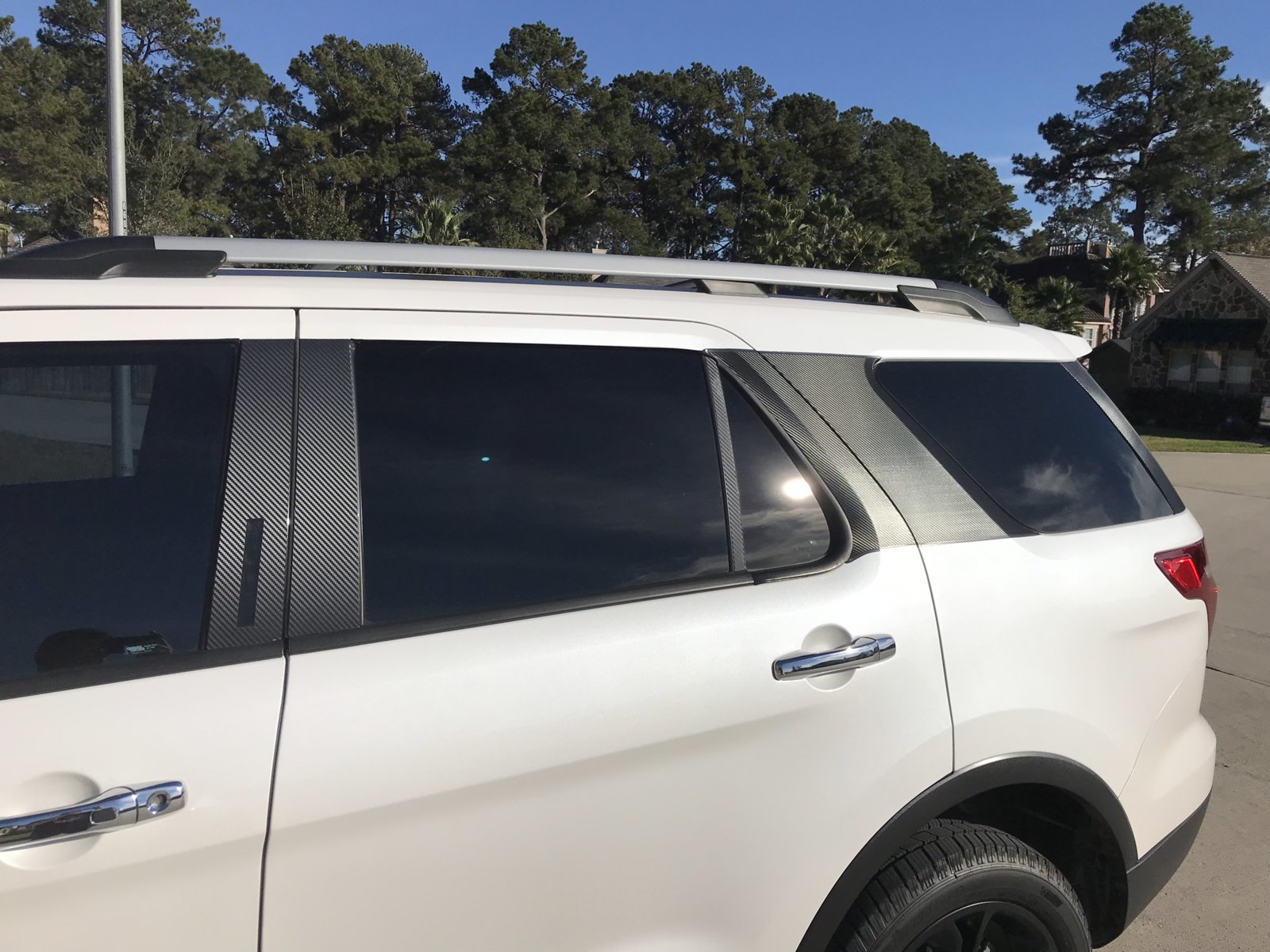

My XLT...
Livernois tune, Pedal Commander throttle enhancer, MGP caliper covers, red wheel center caps, red/black emblems, rear bumper protector, Husky Liners cargo area liner, LED puddle lights.
How do you like the tune? What kinda horse power you’re getting out of it?
Sometime the cosmetic things have to be created by user I haven’t really seen anything just terribly sic. The ex is not really a sporty statement vehicle like others. So you kind of have to make vision of your own...like mine. Not blue like yours but it can get the idea across. I have the same intake. Noisey *******. But throttle raps quickly with it. I think I am gonna make a cold air box for it to see if it will quiet down some. And the exhaust is coming soon too. At some point the n/a 3.5 just wont be a performance monster the eco boost sport models are, but they aren’t as wimpy as some think they are.
Which push bars are those?
