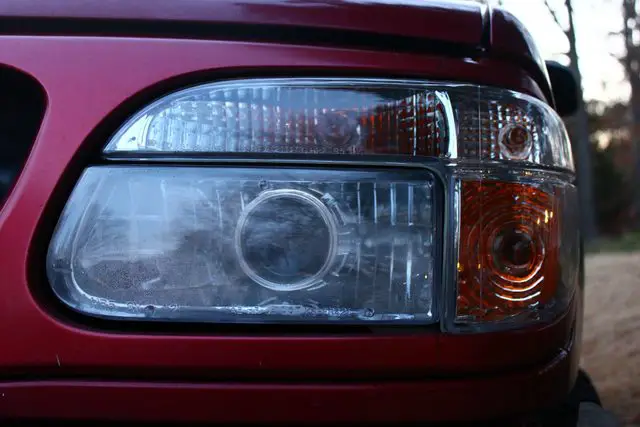

Here's a teaser iPhone picture
I had a little fog on the bottom of the lenses and in the top corner of the turn signal markers... I assume that's because I put them in while it was snowing outside :(
Damn. Looking GOOD!!!!!

Alrighty sorry for the couple day wait but here's a better picture of my retrofit.
Originally when I installed them both the headlights and corner markers had fog in them, but the heat from the halogen blinkers has since dried out the markers. The HID's won't heat up as much as the halogens and dry the fog out of the headlights though. I'm wondering if holding a hair dryer on the lenses for a few minutes one day will dry them out. I definitely don't want to pull it all out and air dry them ughh :(
Since the projector is an open design, you MIGHT get lucky by leaving the bulb out for a little bit, no promises there though. The better thing to do would be take the housing out, take the bulb out, and sit it inside overnight to let it equalize.
