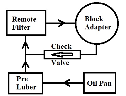

Below is my planned external engine oil flow diagram.

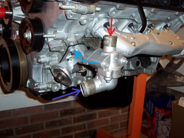

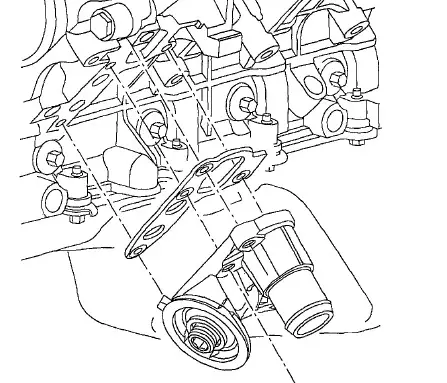

The Pre Luber has a built-in check valve to prevent back flow into the oil pan from the engine oil pump when the engine is running. I've decided to utilize the Explorer coolant/oil filter adapter
instead of the Aviator coolant/oil filter shown below.

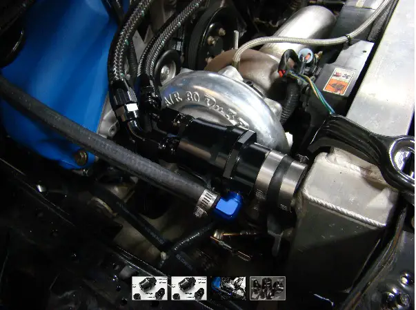

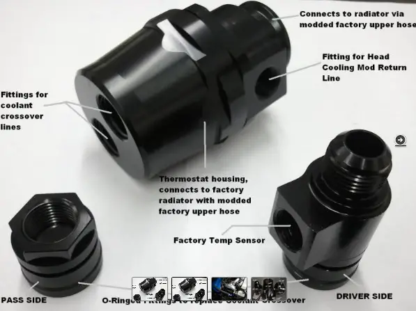

I'm not satisfied with the Aviator cold temperature thermostat configuration and prefer the standard hot temperature thermostat configuration. I'm investigating the On3 Performance coolant crossover delete kit for the DOHC V8 that has an integrated Y combiner/thermostat housing.
The head fittings include a port for either temperature sensors or in my case a port for the heater hose supply.

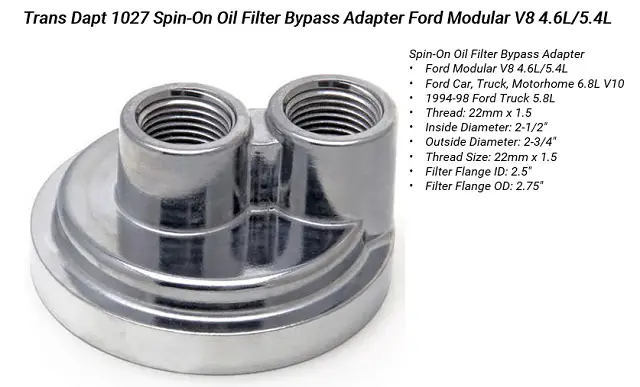

How did you pick that adapter, there are so so many choices, I keep putting off choosing one. There are some that run $50, and others over $100, for essentially the same two port device. I'll need a few for my 302 vehicles.

I like that check valve, thanks for the reference. I'll also need one for the pre-lube circuit most likely.

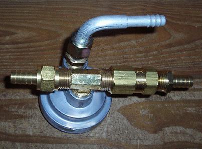

The adapter is similar to the one I installed on my 4.0L Sport which is shown below in mock up form.

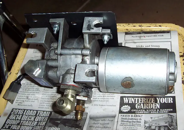

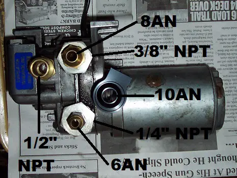

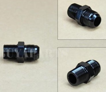

I applied gasket sealant to the ring seal and so far it has never leaked. The main criteria for the 4.6L adapter was the 0.5 inch NPT vertical ports and the correct filter threads. I plan to mount the check valve at the adapter with a short nipple. I wanted to change the pre-luber output port fitting from 1/4 inch NPT to 3/8 inch NPT to match the inlet port and for better flow. But when I removed the out fitting I found that a 3/8 inch fitting would not retain the internal check valve and spring. So I'll have to stay with the 1/4 inch fitting that had no O ring seal which I'll have to find. The photo below shows the inlet and outlet ports with AN adapters and some other fittings for comparison.
In my opinion 8AN for the inlet and 6AN for the outlet is adequate since the time to pressurize the engine is not critical. The remote oil filter adapter ports are 1/2 in. NPT as will be the remote filter mount. I want to avoid restricting the primary oil flow between the block and the remote oil filter so I plan to use 10AN (comparable to 1/2 in. NPT) fittings and hose for those paths. I'll have to find a fitting to mate the 6AN pre-luber output hose with the 10AN hose.

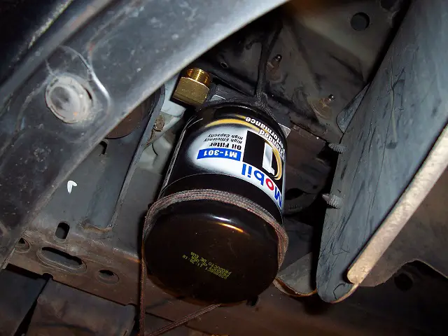

The frame rail at that location is about 5 inches vertically - the same height as my M1-301 filter.
The remote filter mount adds another 1 5/8 inches vertically so I'll probably make a plate and attach it to the rail. Then I'll attach the mount to the plate to keep the bottom of the installed filter slightly higher than the bottom of the rail. The suggested replacement interval is 15,000 miles for the Mobil 1 filters which would be every 5 years or more for me. I change my full flow filters annually. I prefer vertical filter mounting.
I'm thinking the same thing, make a plate to move the mounting adapter up higher. In the 2nd gen, above that is the emissions hose and solenoid, and the bottom of the battery tray. The right side has the AC line and ABS wires etc, minor things. The plate to raise the mount up might need to be a "T" or "L" shaped thing, the frame rail is not flat on the sides in some places. I like the one year mark to try to get fluids and filters to reach. Then they can be done when I want to, say all of them in the Spring each year, or late Fall if you worry about cold affects.

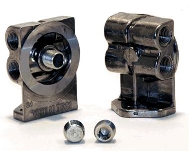

The Derale 25708 didn't work out. The ABS module with mounting bracket above the frame rail interferes with the remote filter mount top port fittings. So I ordered a Wix 24764 remote filter mount with dual side ports (1/2 NPT).
The dual ports will allow me to eliminate the T fitting that merges the preluber output with the block adapter output. Since there is only about 5 inches of frame rail horizontal space available to mount the remote filter adapter I'll install a street elbow on the forward inlet port.

I also liked those multiple outlet filter mounts. Chosen well, those can reduce the number of fittings needed(the "T" fittings), and they can come in left or right outlets.

The M1-301 filter has a specified height of 5.2 inches and extends below the frame rail so I'll purchase a shorter Mobil 1 filter with the same mounting thread (3/4-16) and approximately the same filter diameter. I may have to install the inboard aft fittings and hose before installing the remote filter mount due to limited accessibility.

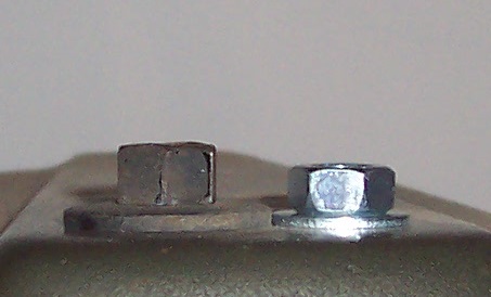

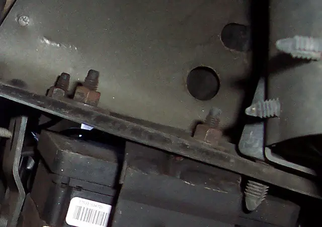

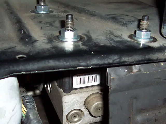

The easiest way to mount the preluber in my selected location is to use the ABS module bracket protruding studs. However, I needed more exposed threads for a mounting plate and additional nut on each stud.
Note the stock round hole above the stud on the right in the photo. It's large enough for the preluber electrical connecter to pass thru and is slightly accessible from the engine compartment. To obtain more exposed stud threads I replaced the stock integrated nut/washers with slim nuts and washers.

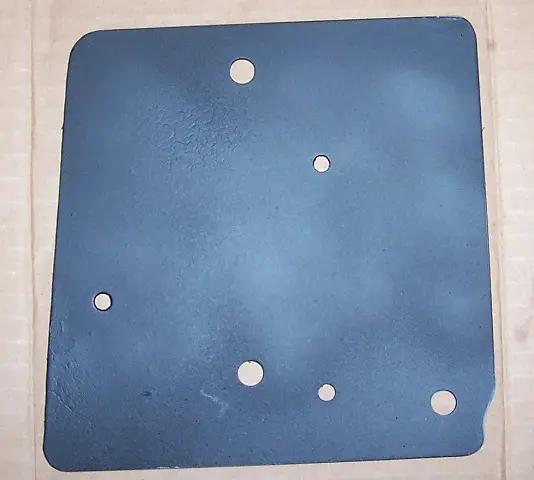

This gave me enough room for another nut and a 1/16 inch thick steel plate which I cut and drilled for the studs and for the preluber mounting bracket.

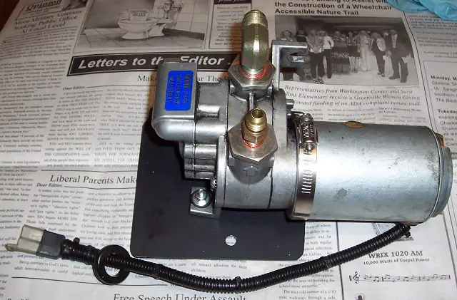

Prior to mounting the preluber to the plate I removed the inlet port adapter and cleaned the inlet screen of the couple trapped metal particles. In my opinion, the output of a preluber that pulls oil from the oil pan should always go to a quality oil filter.
Did either of you look at the Infinity Aerospace pump for the explorer or sport 4.0 sohc application ?
I didn't because I wasn't aware of Infinity Aerospace's pre-oiler at the time I did my search. Their GP301-12 is listed as 12 VDC / 60 PSI / 3 GPM – 11.4 LPM / 10 AMP CB / weight 3 lbs. For the weight and current draw of the unit I suspect 60 psi is the max pressure and 3 GPM is at no pressure. There is no mention of a pressure relief valve/bypass. With no relief valve if flow is restricted and the pressure increases to 60 psi the pump will probably rapidly overheat and if allowed to continue to run will burn up. I would demand a pressure vs flow graph before buying one.

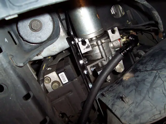

I installed snug fitting M6 bolts thru the supplied grommets and washers and nylon locknuts to mount the preluber to the plate.
A test fit of the assembly indicates there is a chance that everything may fit in the space available.
I'm a little concerned about the space available above the frame rail for the two -10AN and one -8AN hoses. I guess the next step is to cut and drill the remote filter support bracket.

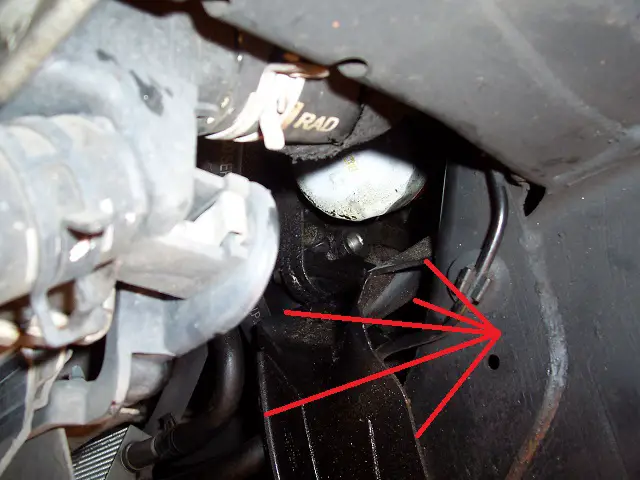

I'll have to remove the oil shield for the stock oil filter because it interferes with routing the preluber inlet hose aft and downward toward the oil pan drain plug.
It also would interfere with the power steering fluid cooler that I hope to move outboard enough to make room for an ATF cooler.
The preluber is ready for permanent installation. All of the fittings have been sealed with high temperature red RTV silicone.
The electrical wires are protected with a corrugated loom and a grommet was cut to insert in the hole after the connector has been pushed thru. I detected a few degrees of rotation of the motor housing when the unit is energized so I installed a large hose clamp over the intersection of the base and the motor housing to prevent any rotation.
