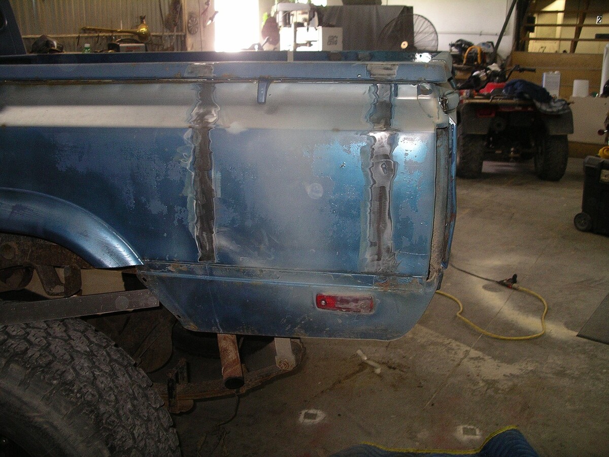

Finally did something noticable. Bobed the bed 13" today. Didn't turn out too bad for 2 guys that have never attempted anything like this before.
Plasma cutter made the job go a lot faster.
Yes, I love having my picture taken!
Added in a crossmember
Welding her up.
Finished product!
One step closer to getting it on the road! :bounce:
