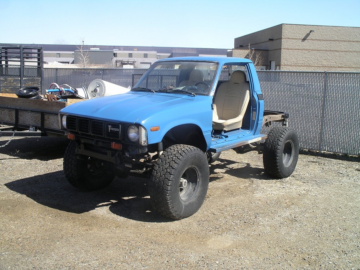

Its got color!
Finished floor and tunnel.
Fancy shifter boot.
Didn't turn out bad for a $15 paint job with very little prep work.
Next step after reassembling the front and interior is deciding on what to do with the bed. My original plan fell through and I don't have the money to build a flat bed. Right now it looks like I'll just shorten the front of the old bed and run it for now.

what kind of paint did you use
Good old Rustoleum enamel. $9.00 quart at Home Depot and easily touched up with a rattle can! :D
