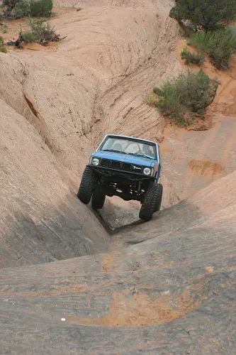

Made it to EJS last Saturday. Ran Hell's Revenge. Other than the over stiff rear springs (getting replaced tomarrow) and my P/S pump failing it ran flawless. Walked right up Hell's Gate like it wasn't even there.
