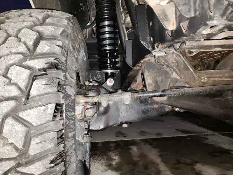

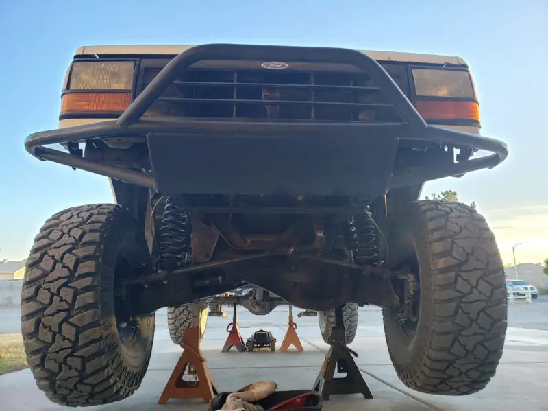

Still might need to go to a little stiffer spring but shes back on the ground.

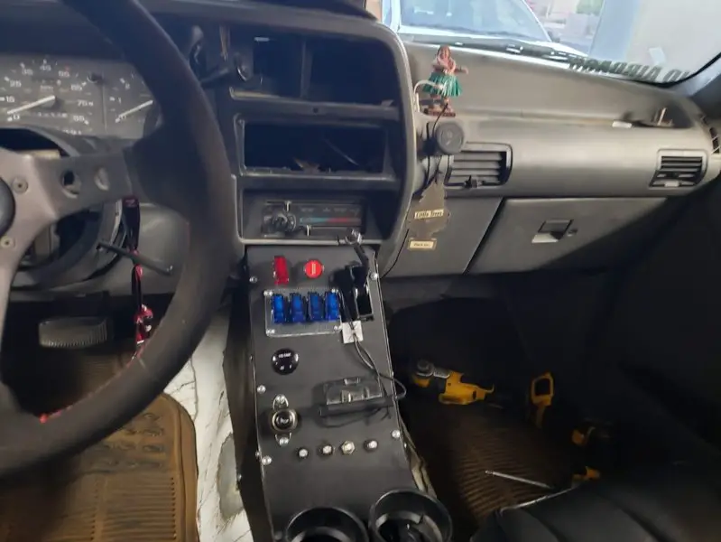

Now I need to test the sensor wires going into xfer case and see about installing some idiot lights for 4wd H and L.
ALso need to build mount to get GPS moved up into the radio spot and old 4wd button location.

What spring rate did you get? too soft?

Cant quite remember where I started with springs but ended up with 250 over 300. I think i originally had 200 over 250. All is good on that side now.

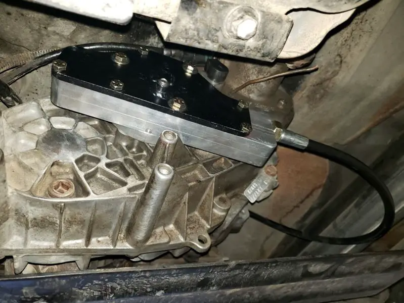

Dewalt multi tool is always a life saver. After I drilled hole in floorboard for new cable for 4wd shifter cable it was perfect for trimming without removing entire cable.
Adaptor took some fighting and cursing to get all sitting nicely and moving freely. If cable is routed and mounted it is not a one person job to get on xfer case as cable wants to fight you while bolting back on. Originally installed while in 2wd and it wasn't wanting to push all the way to 4lo but removed and aligned in with everything in 4lo and now seems all good and hits every position.
Maybe saturday about 4 or 5 am will take out and test on trails to see if everything wants to stay in place.
Took forever to get here but the behemoth electric to manual conversion arrived and I finally got it installed. Wasn't too bad to install. Feels adjusted ok and going into all gears. Need to trail test still, its just too hot in vegas right now.
Borg Warner Transfer Case, Electric To Manual Shift Conversion
I like that shifter. Glad you got it finally. Behemoth has a reputation of screwing people but they make very innovative and quality products.
ordered and paid for around march 1st and received about 2 weeks ago. Thought I was getting screwed and keep getting email/texts that it was going to ship. Glad it finally showed and hope it holds up.
