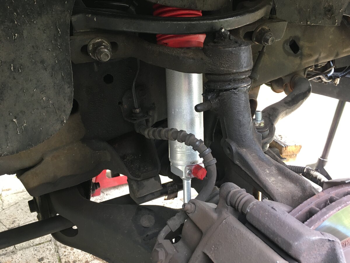

I also had to replace the front shocks, you see someone replaced them but used the old factory shock bushings and they were beat.
Trying to loosen the top shock nut was not possible, it was twisting the threaded stud part right off the top of the shock.
So I wanted a higher quality shock, and I have these Rancho RS9000 adjustable shocks on my race truck that I like a lot.
Two Rancho shocks installed today and adjusted 1/2 turn clockwise from fully loose. It rides a lot less bouncy now!

Empty pool table and no balls is a great analogy. The 4.10s do not like highway. But with 4.x4 low you could probably pull a house off a foundation. But on the good side, it keeps you safe, I keep the speed limit.
I have NOS Reflex in the front. The guy in Monroe said they are very similar to the non-adjustable Ranchos. I also have A-torsion bars from a ranger. Very tight with no roll. In the rear I have the coilovers. Gives it a tiny rake. I took home about 1400lbs of patio tile (only local roads under 30mph) and it was fine.
