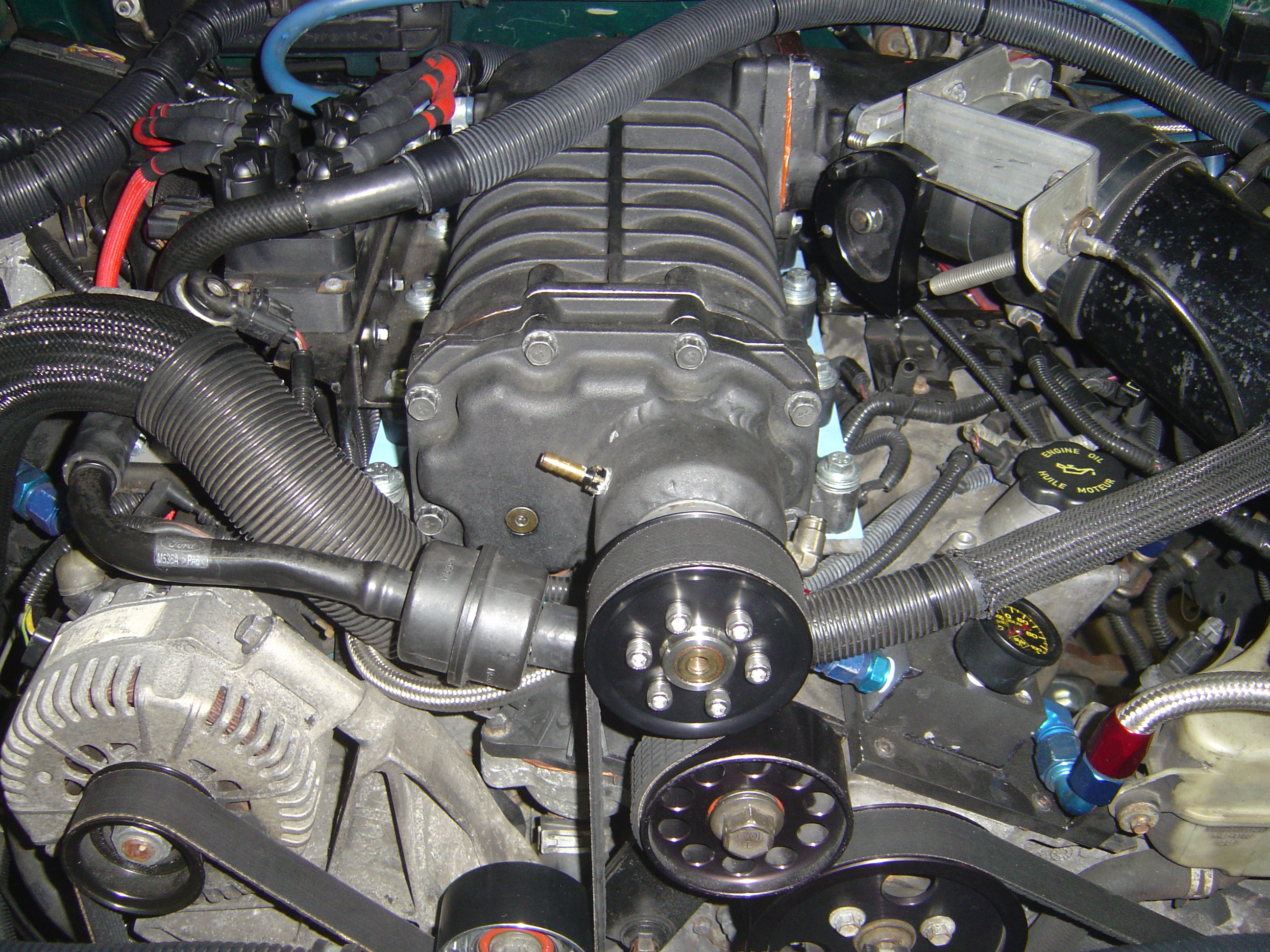

So I picked up a highly modified GT500 supercharger off eBay.
I has been worked on by Stiegemeier porting (http://stiegemeier.com/).
It has been ported, a liquid cooled snout added(not hooked up yet), and best of all it has the custom snakebite overdrive gears in it.
My goal was to reach the same levels of boost I was hitting, but with a larger supercharger pulley or more belt wrap/friction area to eliminate belt slip.
I pinned the boost gauge past 20lbs with a 3.1 inch pulley, and dropped to a 3.2 inch pulley which had me hitting just at 20 lbs of boost.
The best time slip of the day (November 26th) was a 13.23 and it was with the 3.2 inch with less boost.
I would like to try bringing down the boost and advancing the timing to see if it would allow faster 1/4 mile times.
The VMP pulleys that are made for the Cobra using their 6 bolt hub, only go up to 3.3 inches.
I would like to go all the way up to the original Cobra size which was 3.65 inches but VMP doesn't have a pulley ring for that.
Maybe I can just get a stock one to try out, pain to remove though.
My thoughts are that if I can add more timing to get it around 28 degrees(total) at wot with less boost then it may be faster.
I am currently down to around 20 degrees total, with water methanol. 22 caused a little detonation with both pulleys.
I am thinking about getting camshafts to try out next, at least if the engine comes apart it probably wouldn't hurt the cams.
If I got cylinder heads and a piston broke at wot, I am sure the heads would become scrap metal.
