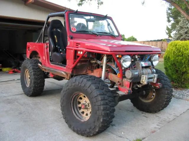

Took this picture tonight of the zuk, almost ready for Moab2004, The Wedding.. I'm in the process of moving the two radios (2m and CB) up into the cage, and adding a dome light (found one for a jeep, that attaches to the cage..)
Tom,
That thing is awesome, you did a great job. I really like the new front end and cage.

Zuki looks AWESOME! See you next week!
