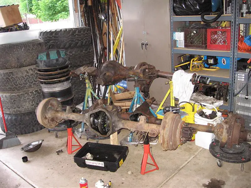

so who thinks i have enough junk in my garage? somewhere in the back of the photo are my new tires... next to the ones i cant even GIVE away.:D
what a mess of axles. I cleaned up around my workspace today...dad was threatening to call one of his patients that wheels to take them if i hadn't cleaned up everything.
must be the time to clean... i just emptyed my garage also to make room for my dana 60 and tires....I found a set of 36X15X16.5 dick cepeck somethin or others in the woods i am gunna use for mock up... they are shot of coarse but its better than the 29s i have now... and im gettin 4-8 lug 16.5X10 inch outlaw II's...if I get it all this weekend ill put up pics in my thread...
that is "cleaned up" lol. my buddy is supposed to be taking the 4 tires i dont need. His dad needs the wheels for winter rims for plowing, and hopefully this guy is going to take the 44 and rear 60 off my hands. He needs matching ratios, so to make the sale, i have to sell him my rear 60 that i already started cleaning up. not that big of a deal though i guess. I only got the hubs cleaned and painted and all of the gunk stripped off of the housing.... guess i'll have to do it all again.
