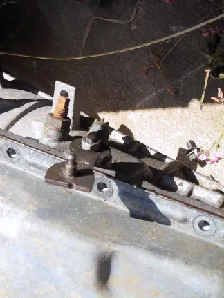

This is in my wife's 92 Sport. I pulled the dead A4LD out, and replaced it with another A4LD I got from 410Fortune (thanks Jamie).
The 92 hooks up to the shift arm with a small ball and socket deal.
The replacement trans came from a 93, and has a different style of attaching. This is what I have. It's the left arm.
Can anyone show me what the cable end looks like?

Yeah, a pic would really help me understand. :) I'm wondering if there is a piece missing that joins the cable to that round hole.
Nobody wants to post me a pic? :( :( :( ;)
I could also use one of the bracket.
