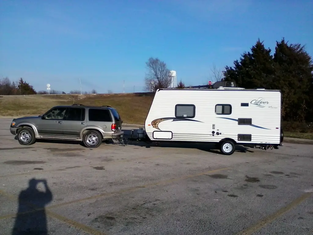

Fuel stop on the way from picking it up. (Had a lot more of those on the way back than on the way there!)

Nice combo. I've always liked that color scheme.
She's definitely squatting a bit. You might have headlights in the eyes of oncoming traffic. Definitely check the TW to see if over 500 lbs.

took the camper to a local site for the weekend to "get a feel" for it before heading out for a long trip (if anything is gonna go wrong I'd rather it happened here close to home not 200 miles from here). The weekend was fun, informational, and I had a chance to see how the improvements worked out. With the add-a-leafs the explorer is much more level when hooked to the trailer. I also flipped the 2" drop hitch so it is raising not lowering, and added a sway control bar. It now pulls much better.
Notice how the extra rear springs brought the rear end up. However, the front is still riding high. Did you get the TW measured?
