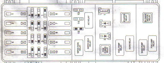

I have a 98 Explorer XLT with a horn problem. I changed the fuse but the horn still doesnt work. someone told me it could be the wiring. does any one here know how i can get to the wires and were they are located and what colors they are. i brity sure it is the wire because sometimes it works and most the time it doesnt. if this helps it does have an alarm.

Hi I'm attaching the schematic for the horn circuit. I would suspect that the horn relay may be bad. It is located in the Power Distribution box under the hood.
The A/C problem unfortunately may be caused by a broken blend door. If you search for "blend door" you should find tons of info;its a common problem with 96-98 Explorers

thanks for the replys they really helped with my horn problem. its working great, just like the day i bought the exploror. as for the A/C i will tackle that problem some other day. thanks agian.
