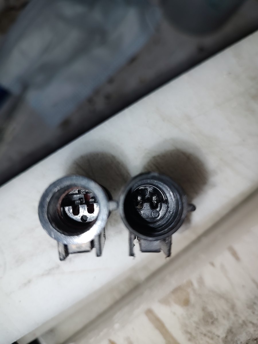

I'm hate to see that Jon, plus the ABS fault code troubles. The new terminal connectors are clearly badly made, the picture looks like they were made with a poorly programmed 3D printer. The new supply chains and parts sources have vastly reduced quality, it may not get better for a long time.

The pins are off position in new connectors, which are cheap china **** show with no removable pin lock, all one piece. Had to use pin extractor to remove pins from new plugs.
Picture shows mis alignment. Good connector on leftView attachment 442607
