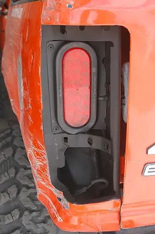

There's a problem though. The LED tailights do not allow the turnsignal relay to activate. I've heard of this problem before, but I'm not sure what the cure is.
Change the relay to the electronic relay, or put a resistor across the lamp.
The basic problem is the LED's don't pull enough current for the clicker to work - it's not just a relay, it has other stuff in it.
ya.... what he said :D
same issue with my LED bulb's
Thanks Jeff, I just ordered a pair of 6 ohm equalizers.

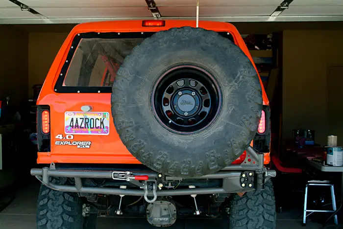

Here's a shot with them on. They appear brighter in person.
attachment.php
One more thing. I installed the 6ohm resistor and the turn signals are working fine.
