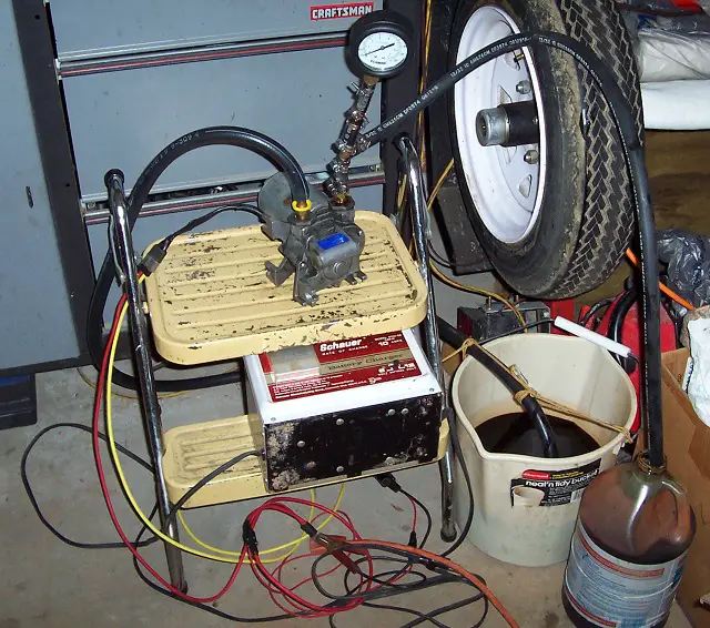

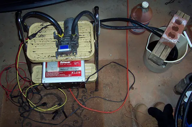

This morning I kluged together a setup for my first test of the pre-luber. The pump came fitted with -10 (or -12) O ring to -6 AN adapter at the outlet port and -10 (or -12) O ring to -8 AN (I think) adapter at the inlet port. The collection of fittings that came with the pre-luber contained appropriate hose barb fittings for 13/32 in. dia. and 1/2 in. dia. hose that I had on hand. The lift is about 24 inches from the bottom of the bucket containing a gallon of old oil to the top bend of the inlet hose. I inserted a small flat blade screwdriver into the yellow wire connector and connected the battery charger negative alligator clip to the screwdriver shaft. The positive alligator clip is connected to the red wire terminal.
The pump motor ran fast just a few seconds after the battery charger was plugged into the extension cord and then slowed when oil reached the pump. I didn't have time to measure the flow but there was considerable activity in the bucket. Current flow is about 15 amps at turn on and then varies between 10 and 12 amps continuously. The pump is not very quiet laying on the metal step stool but came with 3 mounting insulators that should quiet it some. My next test will be to measure the flow and then add a pressure gauge and an outlet restriction to compare the flow under pressure. 11 amps at 13.6 volts equals 150 watts or .2 hp. The current flow will probably increase with pressure. I have a 30 amp relay that should be adequate to enable/disable the pump.
Edit: The pump flow with the hose configuration shown about 1.5 gal/min. which is less than RB Racing's smaller pump ($300) rated 2.6 gal/min at 0 psi.
