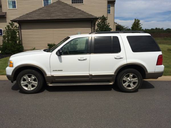

2002 Eddie Bauer test drive
I've been looking for a 2002 or 2003 Explorer with RWD and the V8 in the local area for almost a year. Today I test drove a 2002 Eddie Bauer in good interior and exterior condition with 121K miles on the odometer.
The only mechanical issue is a slight 2 > 3 upshift flair after the transmission is warmed up. No engine knocks so probably no spun bearings like on the Aviator engine I bought. Unfortunately, the seller can't let me buy the vehicle until he finds a suitable pickup truck to replace it. I'd like to get it in the next 43 days so I can reuse my Volvo Turbo Wagon tag. For a V8 I was surprised at how sluggish it was for normal acceleration from a stop. But then it's heavier than my Sport, the A/C was running, and it doesn't have a supercharger to assist low end torque. The head gaskets were replaced a year ago and the heads resurfaced. The transmission was rebuilt by a national franchised shop 3 years ago. Since it's going to cost me $3500 I'll drive it as it is for a while before pulling the engine. During that time I'll try to understand the cooling system and determine how to modify it for the DOHC heads. I doubt there's enough room to install the DOHC heads with the block in the engine compartment. The heads won't help low end torque so I know I won't be satisfied until there's a blower on the engine.
That trans flare is more than likely a worn servo pin bore in the case. It's very common on this trans. Most rebuilders have a repair kit to install brass sleeves, but the trans has to be completely torn down to do it. There are 2 bores that wear out. The 3rd gear band/ intermediate band and the 2nd/5th gear band/ overdrive band. if I were you, I would just drive it until you do the swap, then get it rebuilt. It's going to probably need some upgrades with the new power anyway. My old explorer didn't have 3rd gear at all when I bought it, the band had completely broke. It was common on the 2002 explorer also. I drove it for 6 months like that.

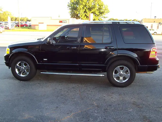

So I agreed to buy the 2003 Limited. I just have to wait for the young lady (seller) to get her dad to send the title from Charleston. The vehicle was purchased new in Greenville by her dad as her high school graduation gift. I rather like the color scheme with the bumpers and body matching black.
There's a very small parking lot ding in the driver side door. I didn't see any others.

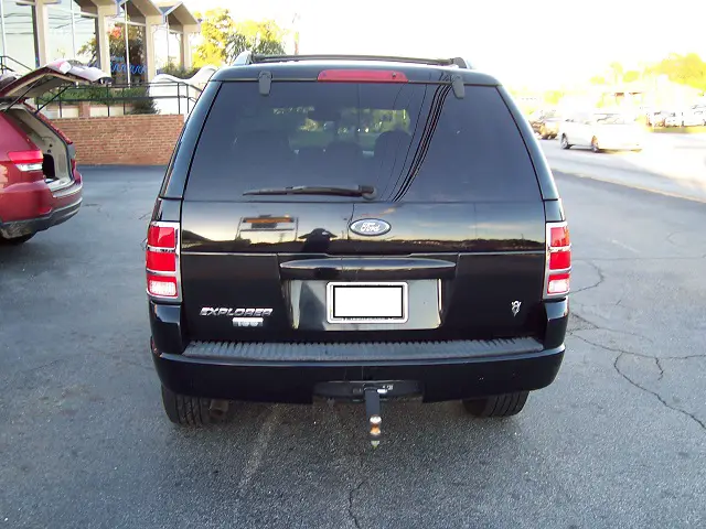

The rear hatch has the common failure.
It has the towing package but she said she's never towed anything. I get to keep the bar & ball.

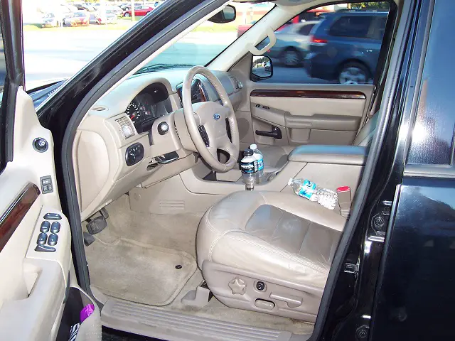

The driver seat is in very good condition for 180K miles.
She said she always kept her car clean and it shows (seats, carpet, etc.).

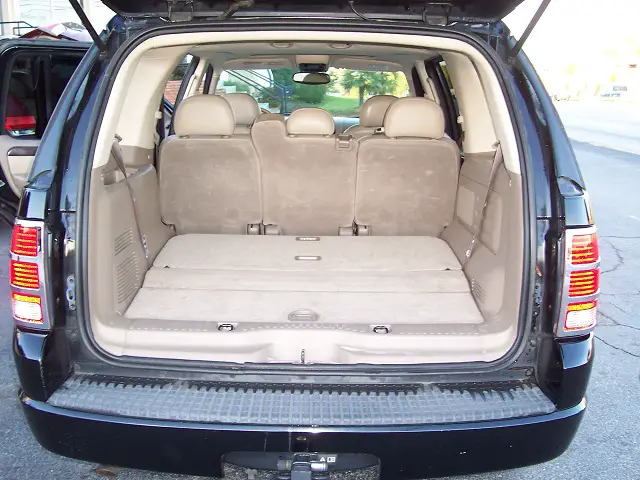

It has 3rd row seating.

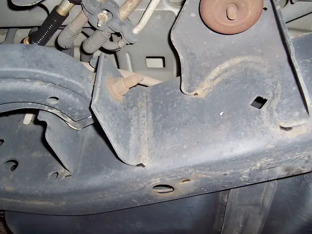

The underside of the vehicle testifies to the advantage of spending its entire life in Greenville.
I didn't see any significant rust anywhere.
