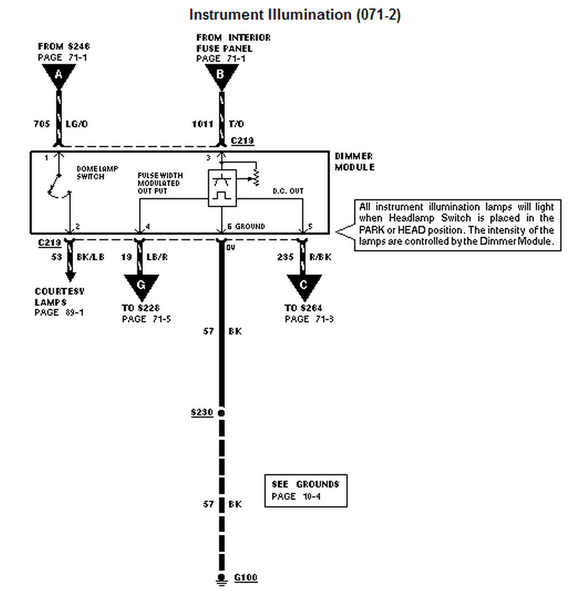

The dash and radio lights quit working. I was told the bulbs are blown but what would cause all the bulbs to blow at one time. the specialty bulbs such as the warning, high beams, and cruise control, etc. still work. only the instruments and radio and heater control lights don't work. fuse is good. Any help /words of wisdom would be greatly appreciated.

Could also be the dimmer switch.
^ This.
Either the Dimmer is bad or a ground connection is lose. See below.
