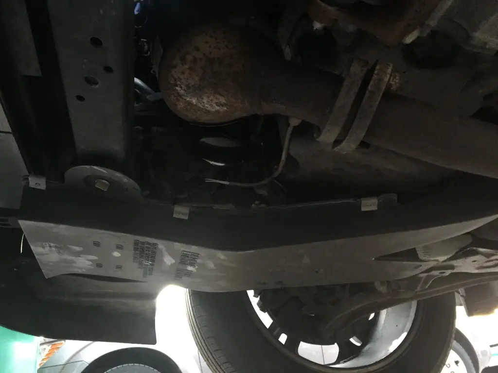

Well I thought of doing a write up, but Might be overkill.
So I will post a few photos for reference.
1 Safety first! Make sure you can safely get under the vehicle.
2 On the sport there is some duct work that helps cool the rear turbo It has to be removed
3 Because the filter is straight
I like to fill the filter before Installing
that way it gets oil pressure that much faster, reducing engine wear.
Just a few photos for reference. Hope it helps if you have not done a oil change on your sport yet.
