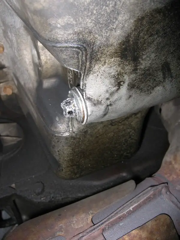

here's my lovely headache
lol.. it looks like something went to gnaw on it..
Looks to me like you would want to hit the outer washer part of the bolt careful not to hit the pan you will get a lot more leverage that way. Hit the edge in (make a indentation) to give yourself a good place to hit the bolt lose (sideways) you can due that in a few places. I see why you are having problems thats alot of surface area for a little bolt.
i had similar problem with the fill plug on my bll's mitsubishi 5spd. so i took it off with a big pipe wrench after grinding flat spots on it with a 1/16 cut of blade in the angle grinder, then welded a nut on top of it after it was off.

You don't weld to the pan...just the nut. Shouldn't be an issue unless someone really gets carried away.
You can try the chisel method...and I like Jamie's idea of grinding flat spots. But that is a perfect candidate for a welded nut. That also appears to be an aluminum pan. I would want to save that if I could.
grinder + 30 seconds = two flat sides = cresent wrench and done
thats the first thing I would try, then pull out the welder :)

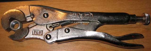

I know you already tried vice grips, but for future reference the one below is designed to grip nuts/bolts on the corners to give rock solid contact on 3 sides..
oh man those are nice nice!! grind 3 sides flat then with those suckers
nice, i'll keep that in mind.. unfortunately the home depot close to me doesnt really carry a lot of tools.. more on just general home maintennance..
