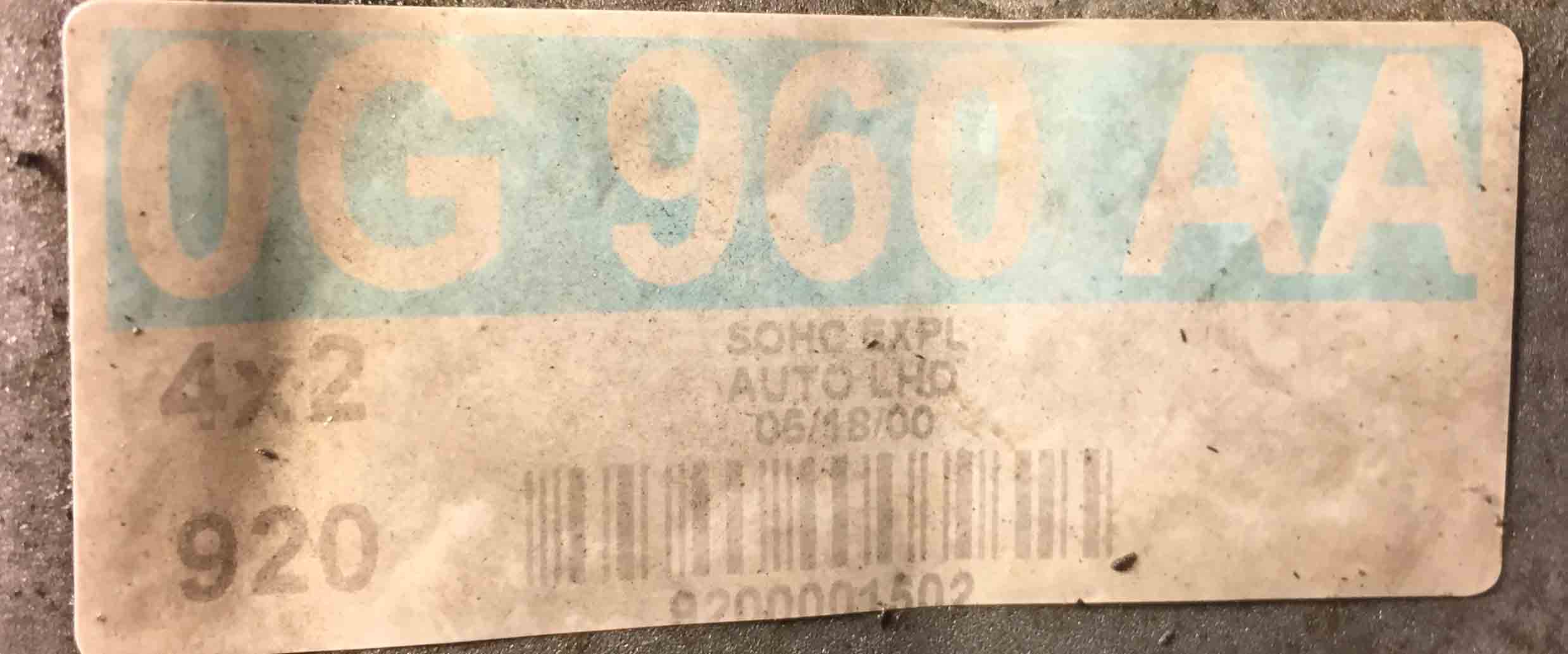

On the 2001 Sport Trac I recently acquired with 255,000 miles, I observed that the oil filter contacts the engine mount on the passenger side, see below. Per the Ford Etis build date of 13.06.2000, engine label build date of 5/18/00, and other observations, this is a Job 1 engine, right?
But it has an FL820s (metric threads) oil filter installed. It was my understanding that Job 1 engines used FL1A filters (SAE threads).
So I'm a bit confused on this. Engine runs great, doesn't burn oil, and the plugs I just removed look great. No chain slap either.
How could this metric thread filter be installed on Job 1 engine? I will pick an FL500s oil filter to see if it fits better in this setup.
