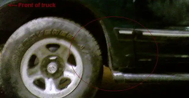

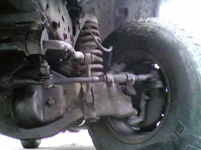

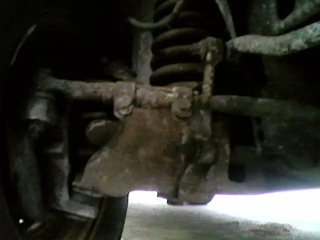

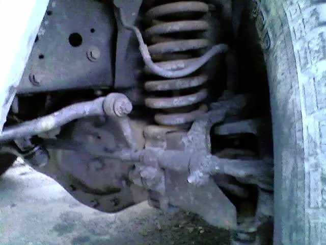

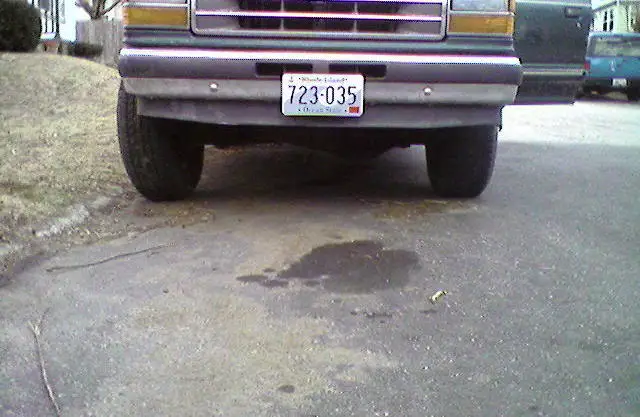

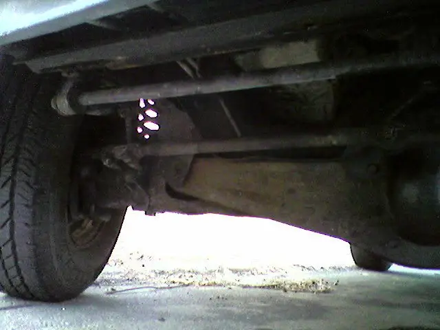

alright guys, I got a couple of pictures for yas... also I took a couple pictures on how the alighnment/wheel position is... these pictures are the best I could do, Hope these help someone help me diagnose my problem, It's been a week since the curb incident and I really need my ex back on the road!!
passanger side...
driver side (wheel is turned left, to give better view. I used a friends camera phone to snap these because it's better quality than mine, so I didn't have a chance to take the wheel/tires off. Hope these are good enough to figure out whats up! or at least what to focus on and what to elminate... I was under there for about 2 hours today moving and examining the radius arms, ball joints, tie rod/tie rod end. etc etc and i just cannon seem to find whats wrong.
anyways, a couple of the driver side...
I took more of the front end but i guess they didn't send to my email?!!

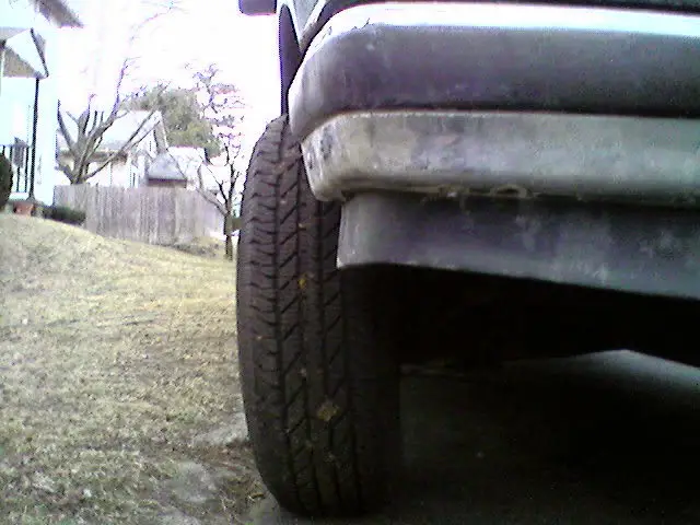

anyways, heres a couple from the front, and side of the truck... showing just how wacked out the wheels are sitting... I retract my previous statement about the wheels being straight, now that i got a good look at it in the daylight.. they definetly aren't, I'm thinking i was maybe suffering from BLINDNESS lol.
they sit so horribly out of place, the passanger AND driverside tires... I don't even know what to begin to assume is broken/bent.
heres the pics... I took the pictures with the driverside wheel facing/tracking straight.. you can see how the passanger side wheel pokes out as if it wants to turn left while the whole trucks going straight and the chamber and wheel position is WAY off on both of them. (I believe the seriously affected tire is the driverside and it's just throwing the whole alighnment and position of the wheel/axle. but i may be wrong and it could be intrirely the pass side, or both...)
front
pass side.
driver side.
please help, any suggestions about what it may be appreciated! I just need to know what to fix, and i'll do it!! I don't even want to drive it to a mechanic just for a quote on what it needs because at this point i'm afraid the wheels going to fall off while driving it :thumbdwn: lol. :D

I want to see a pix of where the driver's side radius arm meets the frame, and one of the whole radius arm mounting bracket. Looking at the last pix of the suspension you posted, it almost looks like the driver's side wheel is pushed back. The angle of the sway bar end link looks funny. I'm wondering if you bent the radius arm mounting bracket....
Also..measure the distance from front hub center to rear hub center (when the wheels are straight) on both sides. They should be equal....
well honestly I don't even have to measure it to tell you that the driverside wheel is definetly pushed back a little!! also the tire rubs pretty good on the inner fender when fully turned left.
if you check out these pics i posted a few days ago on page 1 you can see how the driverside wheel is pushed back and is definetly not centered how it should be.
It's now getting dark so I will get you some more pictures tomorrow in the daylight of the radius arms and brackets, it's just these are located in such an area that it's hard to get a picture with a camera phone even in the daylight.. I'm very close to buying a nice digital cam with a flash and all so getting good and well lit pictures is no longer an issue. but after the parts truck and all a camera will have to wait! :rolleyes: but i will take the tires off and get up in there good and try and get some good pictures for yas... thanks again not sure what i'd do without this site in this situation!!! so rest assured any and all help is greatly appreciated! :D :thumbsup: thanks, Mike
I will snap some pictures tomorrow hopefully if I have enough time before dark, sorry for the delay as uaual!! lol. -Mike

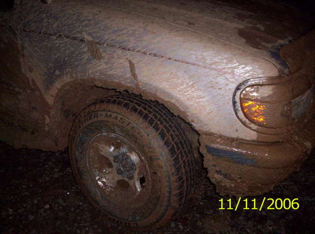

I havn't read the entire post so I don't know what all has been discused. I did something similar offroading, hit a concrete pipe dead center on passenger wheel. Next day after getting some of the mud off I found I had split my steering Rack. I thought I had really messed things up but it turned out nothing was bent and all I needed was a new Steering Rack and a lower ball joint. As you can see in the pic the tire is turned to the right a little(steering wheel was actually turned to the left) and I found the center cap smashed flat. Not sure if 1st gen have a Rack and Pinion or not but you may want to check your steering linkage.
hate to tell you, but you may also have frame damage. look under your truck, and pay VERY close attention to see if there is any bends, or cracking of the factory paint on the frame, or even very small metal spots.
That sounds exactly like my problem... with the steering wheel and wheel/tire position WAY off and all. this is possiblely my problem, or at least part of it... what exactly should i check?
(it's never something easy! lol) anyways nice EX I love to see a rig all mudded up.. :thumbsup: :D

jdraper, how you said the angle of the sway bar end link looks off... I investigated it on my 'parts' explorer, and you're right... on the parts explorer the end link is only about an inch away from the coil spring.. on my daily ex (the green one, with the front end prob) the end link seems to be a good 2-2.5" off.. (just a ballpark range, I didn't measure...yet), just took a quick look at it and it's definetly differant and way off even to the eye between the 2 trucks.
if that helps. also i seem to be leaking power steering fluid now, not alot, but theres a good half dollar size spot under the truck now and the fluid is a little low... it NEVER EVER leaked anything before, so i know this is new.. going to try and track the leak down tomorrow and put a quick end to it!!
