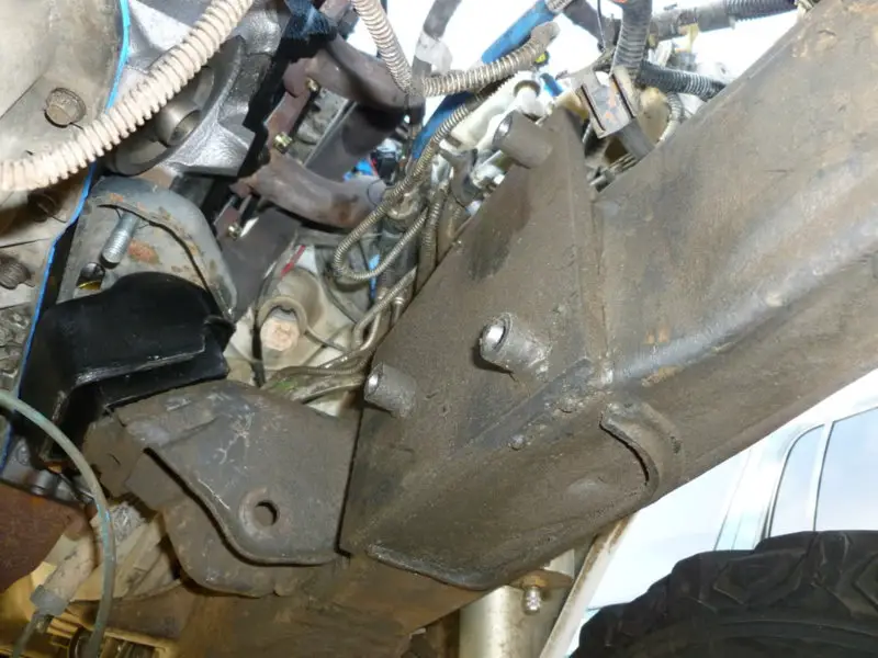

could you post a picture of the steering box installed? thanks.
rjcooperss396
February 1, 2005
419
6
Dallas, GA
'95 XLT

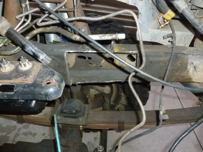

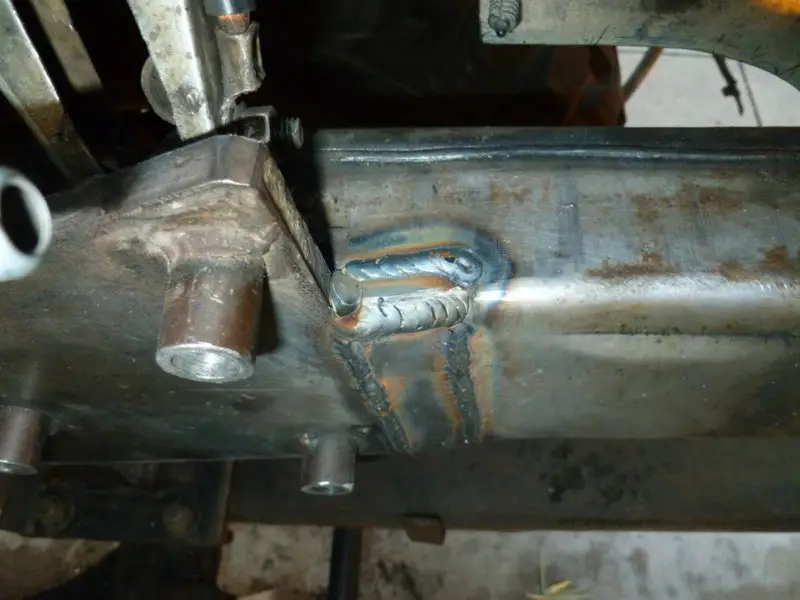

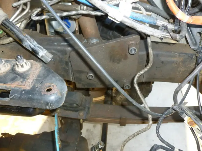

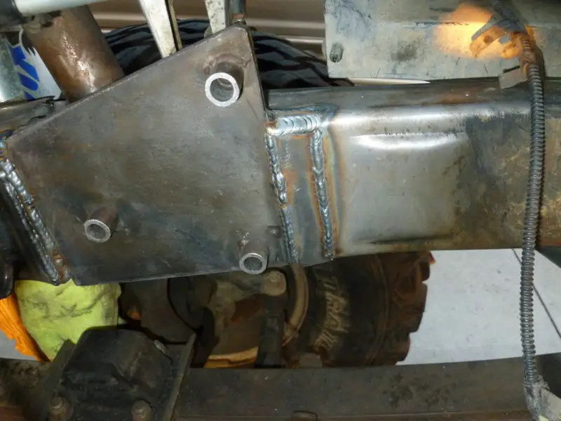

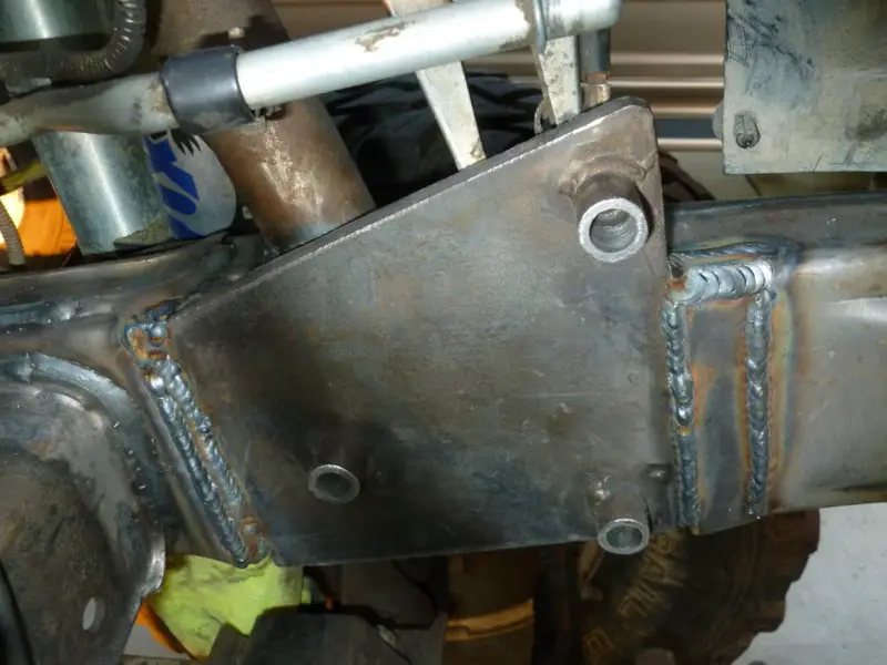

I don't have any of the box installed but I do have some from when I had to modify the bracket for the V8 swap.
The bracket in the old position.
The hole in the frame.
The piece I removed.
Welded in place.

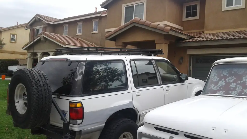

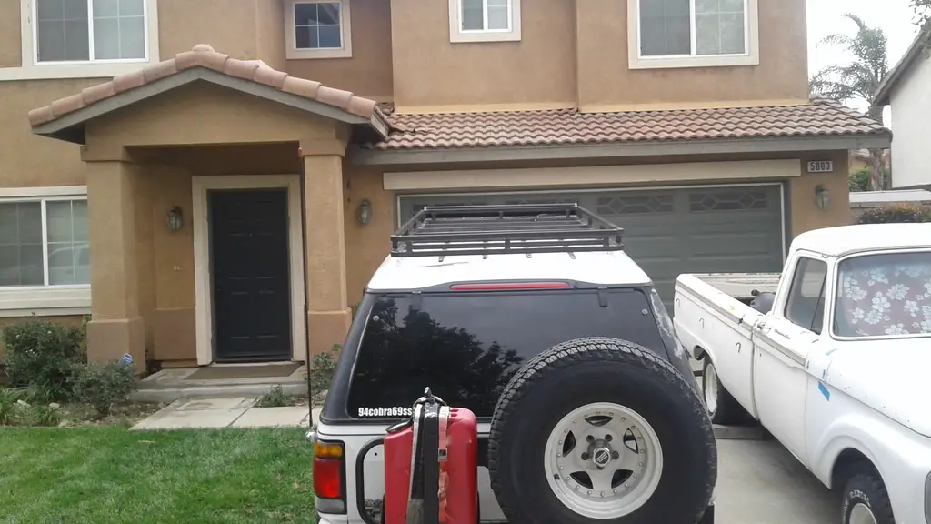

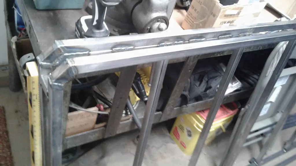

I've wanted to build a roof rack with a mount for a LED light bar for a while now. While talking to my nephew a couple weeks ago he told me that he had a bunch of 1 inch square tube that I can have plus a 40 inch light bar so I decided now is the time to build one.
I searched online to get an idea of what I wanted to build and found that most people using square tubing just did squared off corners which I didn't like. Instead I cut 2 inch pieces at 22.5 degrees to give it a 45 degrees corner. I also made it 4 inches tall because I didn't like the way 6 or even 5 inch tall racks look.

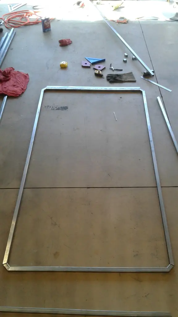

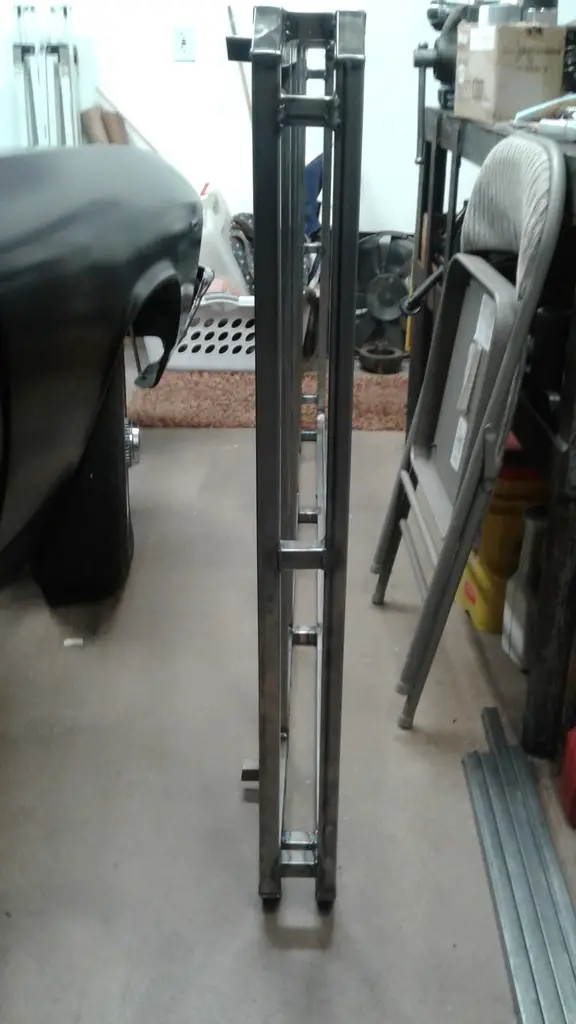

I started out by measuring the roof and decided to make the rack 83 inches long and 42 inches wide. Then I drew it out on my garage floor so that I could lay the tubing out to weld it.

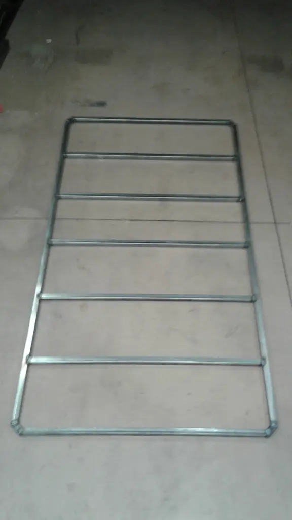

Once I had the frame welded I cut the cross braces and welded those on.

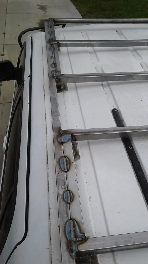

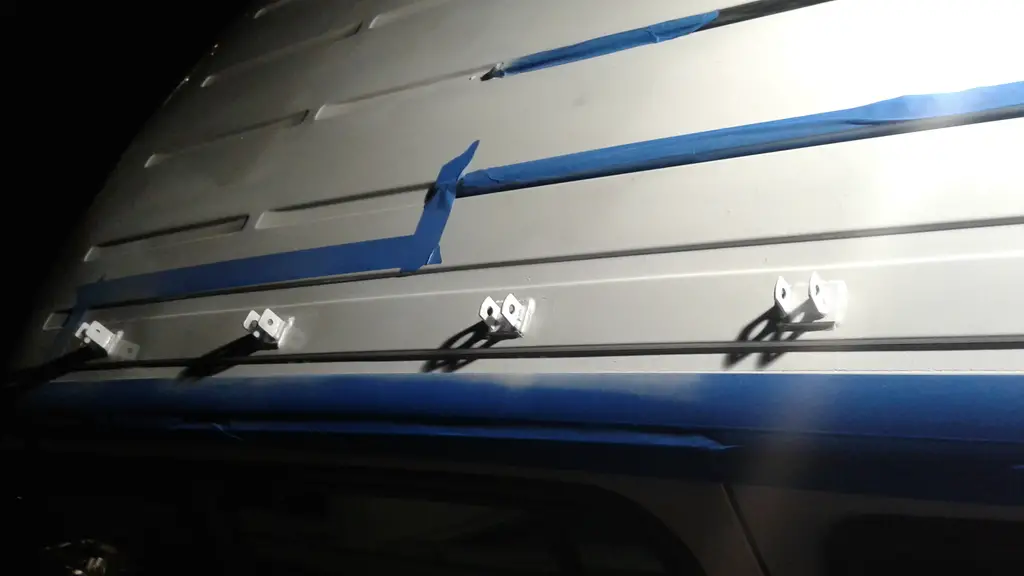

After that I removed the old rails from the truck and cut plates to roof to seal the holes from the old inserts. I welded those on and painted the roof. I taped off the tops so that I had clean metal to weld to.
I then set the base on the roof, spaced it up from the roof and then cut down bars to weld to the plates.
After that I welded the top frame together and cut the tube to connect the top and bottom.

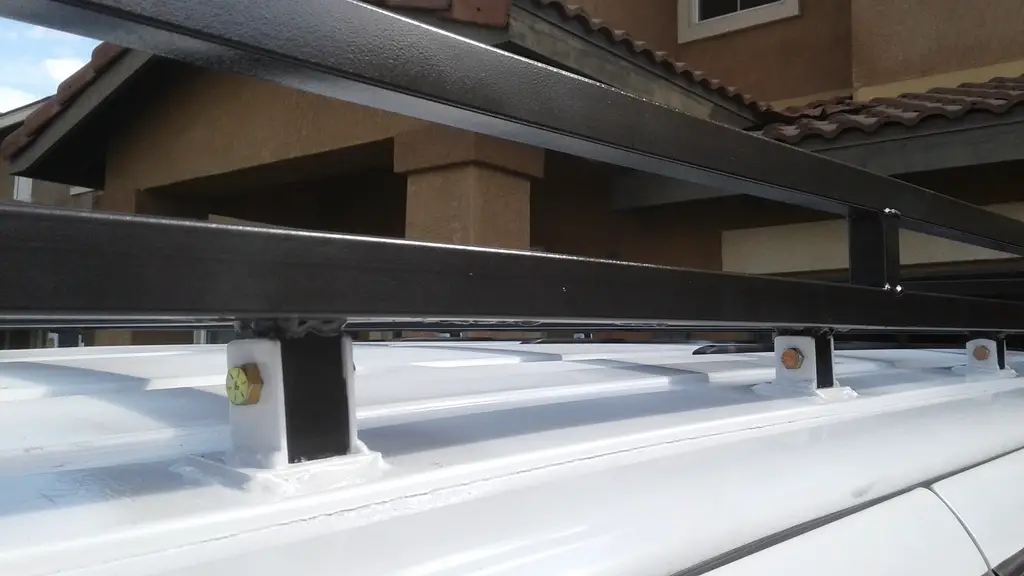

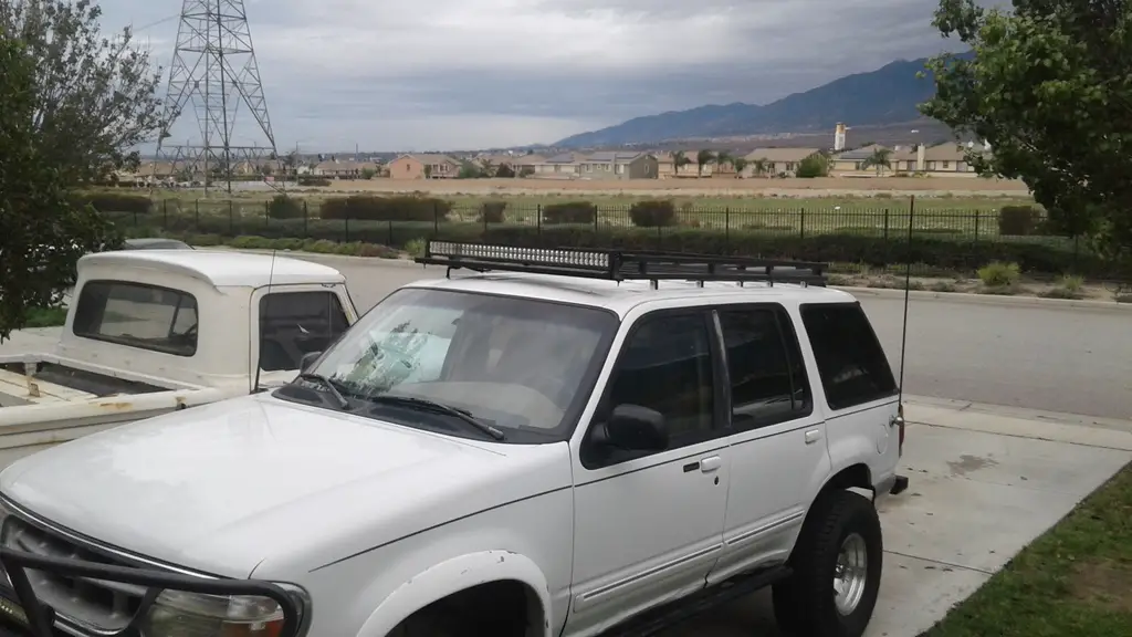

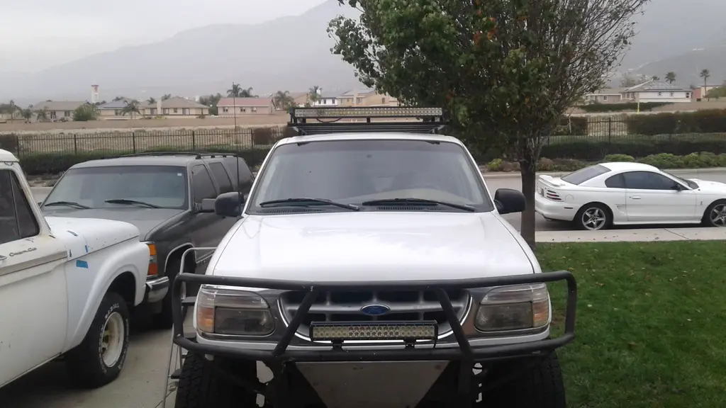

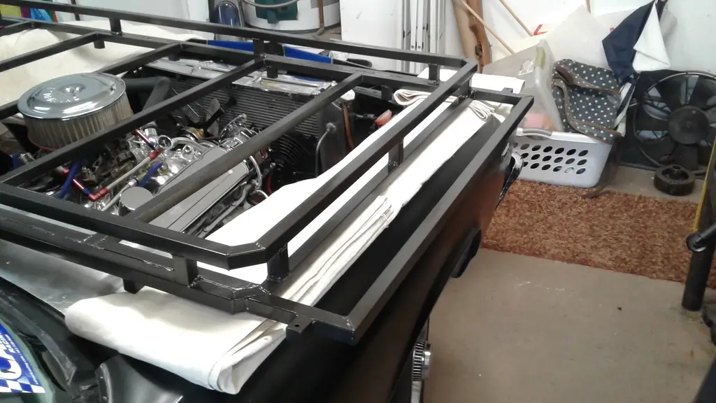

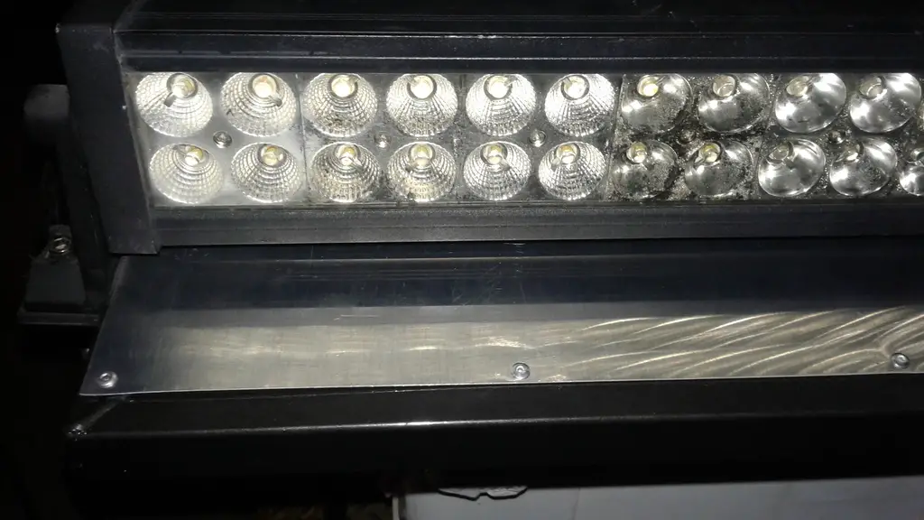

Then I made the base for the light bar and painted the rack.

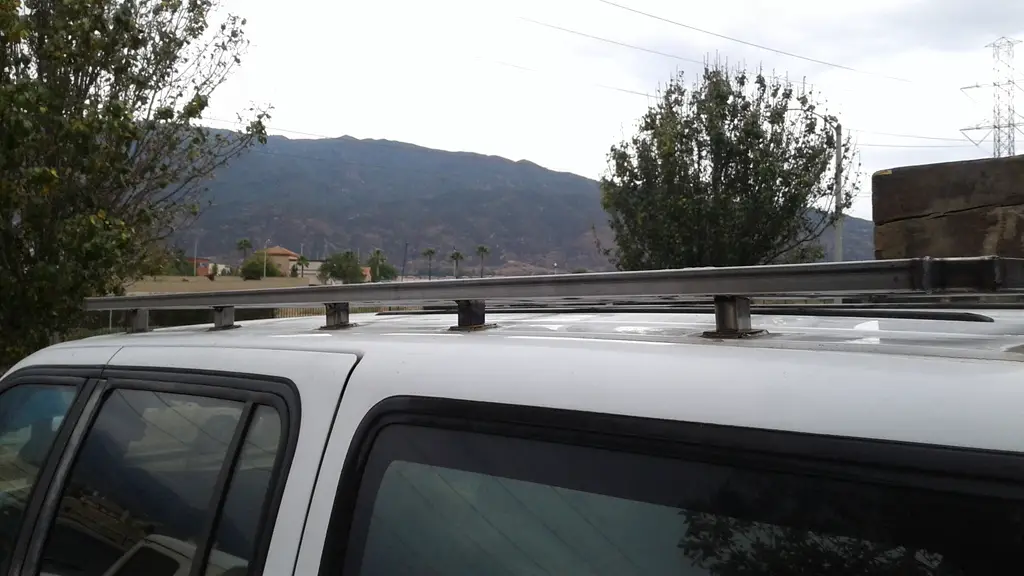

I test fitted it with the light mounted and decided I didn't like how high the light sat with the way I had the mounts. So I cut them off and lowered them. I also added aluminum sheet under the light to keep it from glaring off the window.
I was ready to weld the rack to the roof when my brother convinced me to make it a bolt-on so that if I ever need to remove it I can. So I cut out some tabs to weld to the roof plates and then painted them.
