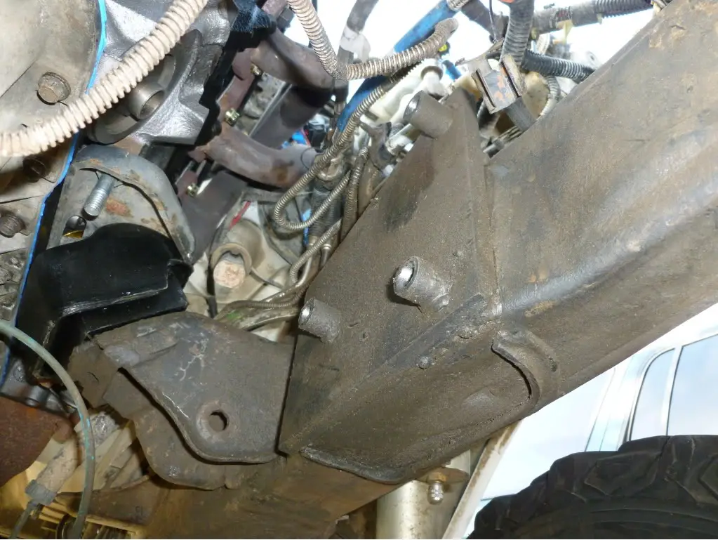

I downloaded the Firefox extension that allows me to see the images so I took a screen shot of the pictures, saved them and uploaded to another site so I could post them again. The first few pictures are how it was mounted when I had the V6. I didn't do the original mounting, I paid a shop to do it because I couldn't weld. The others are of me moving it into the frame more to clear the V8 when I swapped it in. I can weld now so I did that work.

I'll have to look to see if I can find the original pictures. I explained on the first page of this thread what I did. Since I used leaf springs for the conversion it was fairly simple. I built a front crossmember with square tubing and then used more square tubing for the front spring mounts. For the upper shackle mount I drilled a hole through the frame and welded in some DOM that had the correct inside diameter for the shackle bushing. I made the shackles the a little longer than a YJ shackle. In fact, all the measurements for the springs were based off a YJ since I used YJ springs with a bunch of extra leafs. When it came time to weld on the spring perches I towed the truck down to the shop my brother was working at and we put it on the alignment rack and set the castor to the Explorer specs and then welded them on.

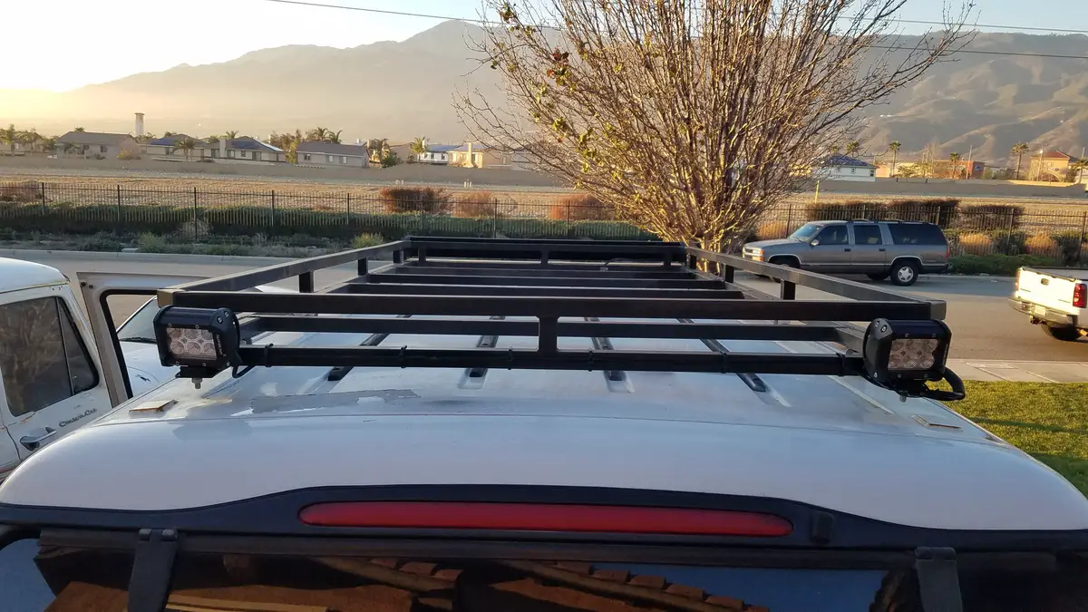

I added a couple of 4in. LED lights to the rear of my roof rack for backing up. They aren't super bright like the front ones but they're way better than just the reverse lights. You can actually see what's around you when backing up at night offroading. I made a couple tabs that I welded onto the rack and then drilled a hole in the lower tube to run the wiring.
