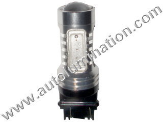

Pictures of the light are kinda worthless. Need comparisons of output.
Also, I wouldn't trust a 22 watt PnP LED. There is no where near enough room for the kind of heat sinking that would need.
The simple answer is no. No plug and play LED will provide better light output than the stock bulb because the the reflector housing is designed for the filaments focal point. Plug and Play LEDs that have their own optics are the best you will get but it still will not outperform the bulbs output. The only way to get better light output from an LED is to make a custom unit with component LEDs. And there is no possible way to cool a 22 watt LED inside tail light housing

And? 22 watts of is a lot of heat to dissipate. LEDs do not tolerate much heat before they fail. I've got a heat sink the size of my fist to dissipate 15 watts in open air. Besides, a 22 watt LED should be able to produce over 1600 lumens easily using any decent LED. It may be using LEDs that can handle a total of 22 watts, but there is no way they are drawing that much. Besides, drawing any more than 17 watts and you lose all the benefits of switching to LEDs in the first place, and that is the lower current draw. The ONLY good way to switch to LEDs is to use custom emitters or arrays that can focus the light where you want it, or do not rely on the optics of the tail light and can take up more space than the bulb to accommodate heat sinking.
