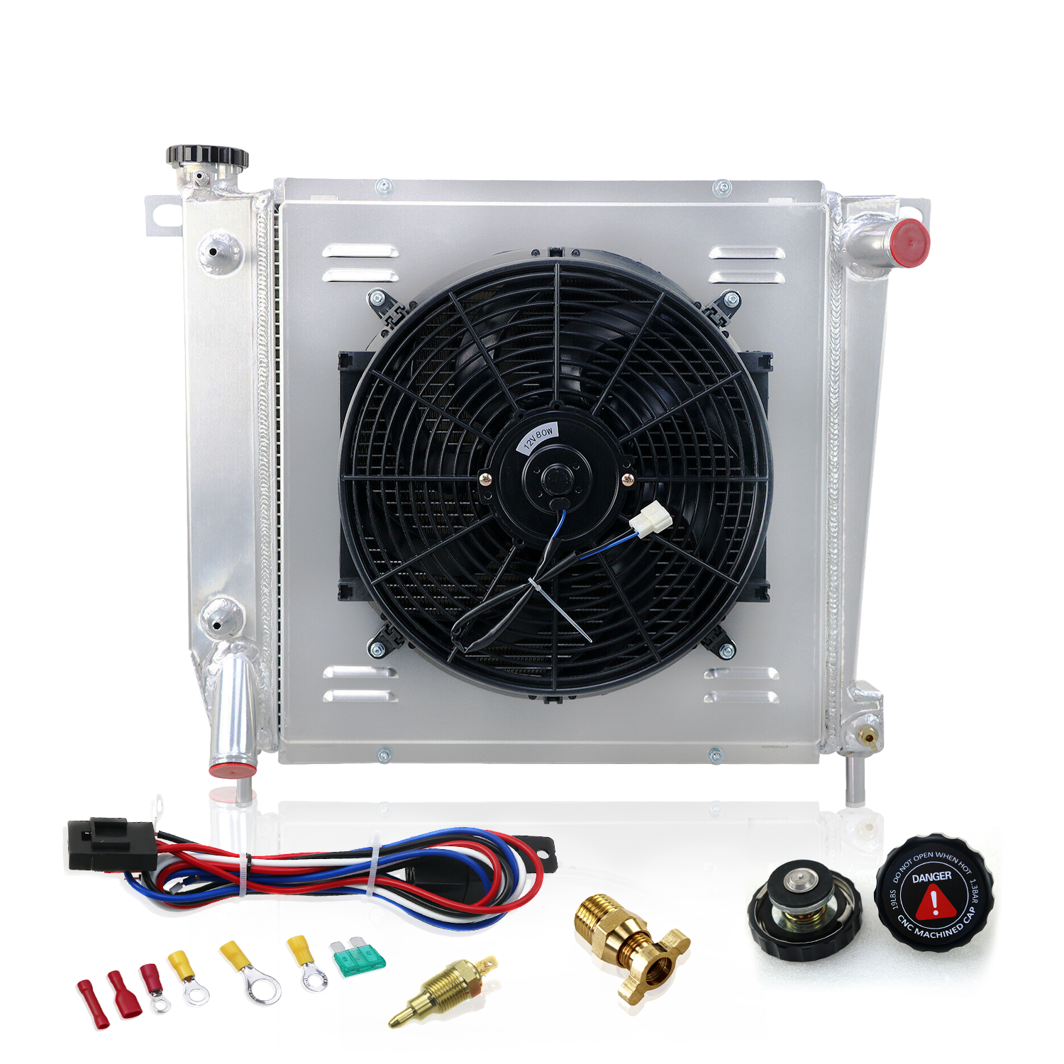

Hi I recently acquired a 1994 ford explorer. There was no overheat issue I just chose to proactively do some preventative maintenance and upgrades at the same time. It ran good but had an original radiator etc.
So. I put in an AlloyWorks 3 row radiator, new acdelco water pump, new thermostat housing, thermostat, proform brushless 14” efan which flows 2900 cfm.
As soon as I got everything installed and running I immediately started having overheat issues. I bypassed the heater core to see if that was it and it helped but I am still seeing high temps with the AC on. Much higher then I saw previously before all the work I did. I’m starting to run out of ideas. Does anybody have any suggestions or path to choose moving forward? I have tried with no thermostat, 180 thermostat, 195 thermostat and there is no difference.
If I’m accelerating hard with the ac on it will climb to the “l” rapidly. Thanks.

Hi yes it does have a shroud. I completely understand the mechanical fan clutch vs efan argument. I just went with a very pricey high cfm fan that flows well over the cfm of the factory fan. I just don’t see how that would be the issue here. But if all else fails then yes I will just go back to stock components and see what happens. I appreciate the input.

If i read this, it should be an upgrade.
It's interesting and expensive too, but if i look at the fan
i would think those tiny blades couldn't get enough air through the radiator. (AC cooler clean?)
The shroud should be cover the whole radiator like this
What about the fan controller, which one you get? If AC is on the controller should override temperature switch
and the fan must run all the time while AC is running.
