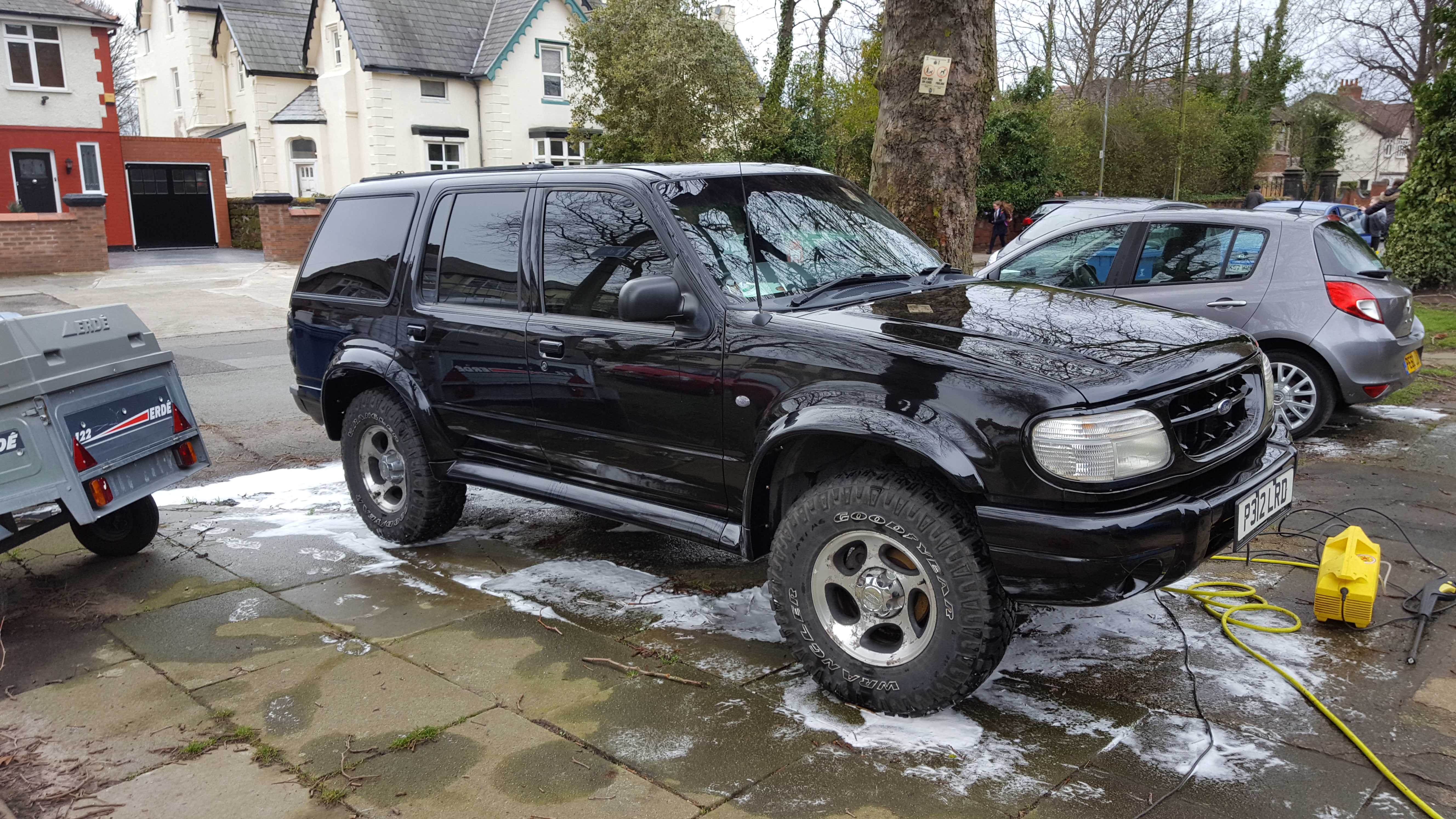

I've had my truck all colour coded. Now my wheels need a seeing to. They're really badly corroded.
Can anyone give suggestions for paint?

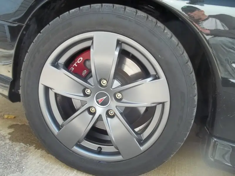

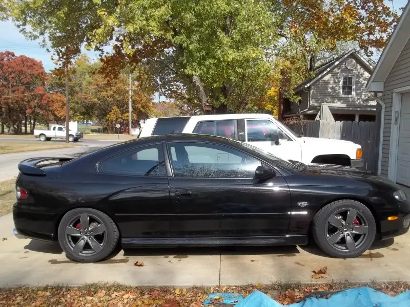

Instead of black like everyone else has, since you're going to the effort, Argento.
It's like murdered silver-looks black at night. Have to use a low gloss clear (40%) to get the metallic effect
Looks real good on an all black vehicle
I'm staying with the wheels that are on though. Was also considering getting the centre caps painted too.

I think if the holes were black, and the rest the above color it would look great.
Black coat first let cool, shoot the dark silver powder, wipe hole clean with damp finger until black remains, then bake again, let cool and shoot the clear.

Getting wheels over here to fit an explorer would cost me loads more than a powdercoated set.
