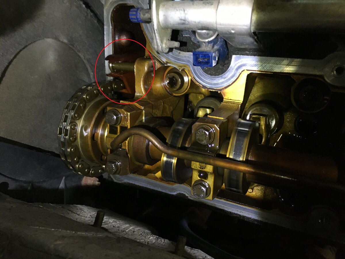

if youre pulling valve cover gaskets, probably already know this, but inspect the one timing chain that goes to the p/s (?) to make sure the guides are alright
Check both sides while you are there.
If the passenger side looks like this, you are in luck!

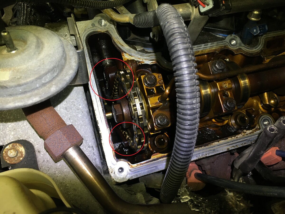

And make sure the driver side is still in good shape. This picture didn't turn out so good but this is the area to look for broken plastic chain guides.
And make sure the driver side is still in good shape. This picture didn't turn out so good but this is the area to look for broken plastic chain guides. View attachment 427749
Ok will do. I am gonna take my time to be as thorough as possible. That is one very clean engine. Thanks for the heads up. All this info is really great.
