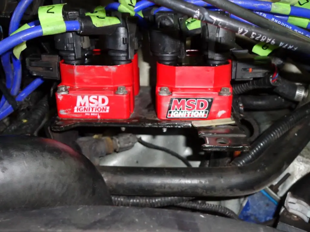

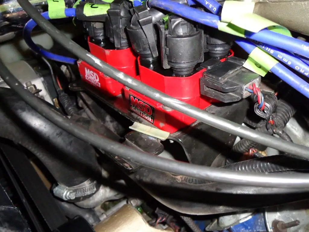

I don't recommend the MSD coil packs. I have a set of those on my truck which I'm about to switch out for stock ones again. I've developed miss kinda of like it is breaking up at WOT and higher rpms. Mine also long cranks every time when it is cold which I didn't know what to expect with the cam and all. Is the long cranking even with a large cam abnormal?
It's intermittent as sometimes it'll fire right up and other times it won't. That's interesting about the MSD, although I have heard the Motorcraft OEM's are good enough on our 5.0 Trucks. It just feels like there's still a slight miss somewhere. Can't hear it through the exhaust, no codes but my gas mileage also has been less than impressive. When I had my engine apart during the project alot of the ignition and air intake parts and sensors sat near the garage door on the ground or in a box on the ground. The seal on the door isn't the best so whenever it rained moisture could have seeped in at times. Because since the engine has been back up I have replaced the Crank Pos. sensor, The IAC sensor, Throttle Pos. sensor, Starter, Plugs, and wires. I still need to replace the upstream pass. bank o2 as well and see if that'll do anything. I'm still getting the rpm drop as well between "P" , "R", "D" shifts.That as well is intermittent , it feels like the colder it is when it decides to do that the lower the rpm drops. I wonder if it is "Cam" related.

Ok, I just installed new coils the other day. And I know you recommended against MSD. I went ahead with them since they were performance and $1 cheaper on summit than the Ford OEM ones so I gave them a shot. I haven't driven too far yet with them just around town. I noticed a better throttle response, snappier shifts(Weird huh?) and the crank was normal or slightly quicker. So far so good, maybe you had a defective coil pack?? Either way I haven't drove too far because I also was fighting to replace the cylinder 5 flange header gasket. I can't get a hold of Bob for nothing so I can get some replacements. So in the mean time I used more of those modified 350 gaskets with some copper sealant. Felt pretty good after that.:D I'll keep you guys posted with more updates later on!

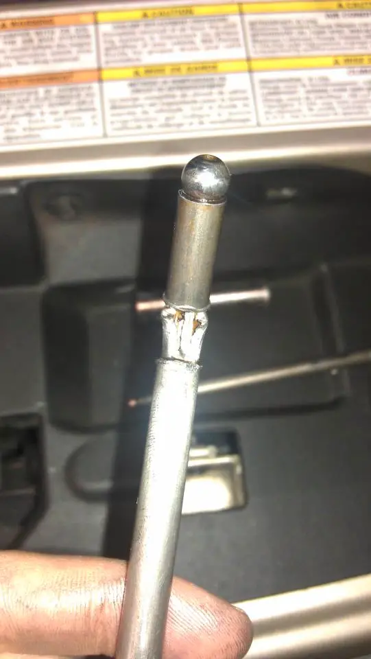

This is the after math of the push rod. There were only 2 Bent ones but ALL of them have that mushroom tip engraving on them from the guide plates. There's a few small nicks on the rockers.

We checked when we pulled the cover off and it looked clean. The problem is that all the push rods are headed to their pre-mature deaths. They all have indentation grooves from the guide plates so eventually the whole valve train would have stopped. The valves looked alright and the rockers mechanically looked okay too. the two on Cylinder 8 had slight marks on them but that's all. Still haven't pulled the pass side off yet. Over the last 2 weeks that tapping sound had progressively gotten worse and worse and the stethoscope narrowed it nearly right on top of that area where this happened. Between cylinder 7 and 8. It just makes sense now that no matter how many times I tried fixing my "Exhaust leak" this noise persisted. It quieted at times but always came back. I guess if that was like that for a while in a sense it was like an internal leak if the valve was opening closing right. I'm just GLAD we caught it now and I didn't try to limp her the 15 1/2 miles home across open highway from the airport.
I just don't know what caused this, my mistake for beefing up the other valve train components and re-using stock push rods. This time I'm gonna have to see about getting the adjustable push rod and measuring out the EXACT size need and buying Stronger ones this time around. It's amazing that the truck ran as good as she did with essentially 7 cylinders. I'll try to get around to making a video so you can see it closer.
Flowtech said the issue was the stock push rods. They aren't designed for Guide plates. Got new 6.25'' 5/16'' Single piece Chromemoly push rods on the way from FTI. They recommended pulling the engine to make sure there's not any damage but I doubt it after seeing it. The two push rods never broke just bent and there was no shavings on the head. I will drain the oil for sure to be safe and get a better idea. After it bent the truck was not driven far before being shut off. On top of that is the speaker magnet on my pan as well. I'll keep folks updated. :thumbsup:
