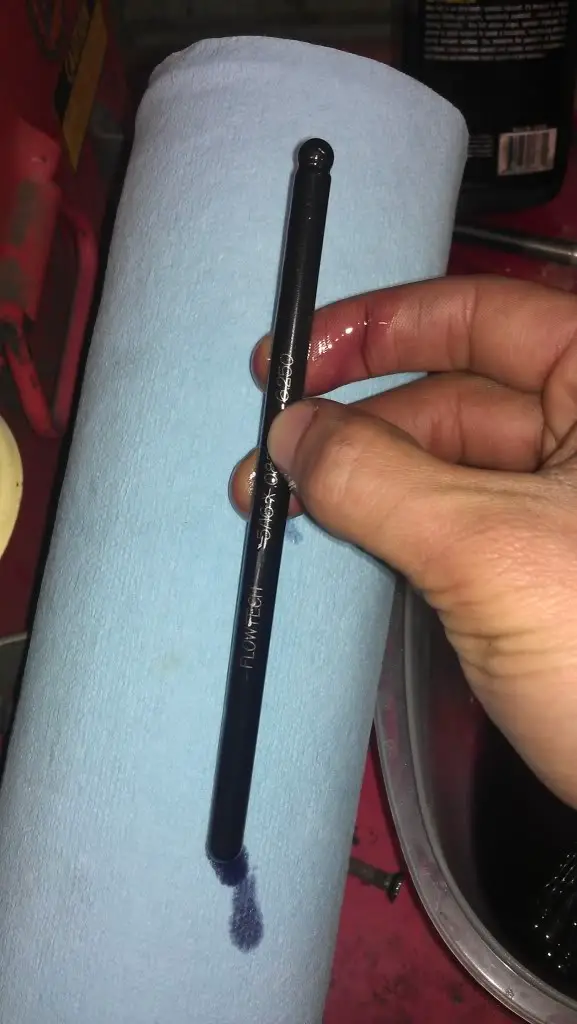

About to put in the new push rods. Quick question though, only one side has the ball point. Which side goes on the rocker side versus the lifter end??
I don't think it matters, but mine were the same on both ends. Both ends of mine looked like the "bottom" of yours.
Thanks guys. Literally just a few minutes after that post I found my answer. Took a rocker arm and placed it over the push rod. It has to be the ball end under the rocker. The ball end allows the smooth pivot of the rocker arm otherwise it would bind up. All the new push rods are in. Didn't start it because we left the compression tester at my friend's brother's house and he'd already gone to bed for the night. We wanna test the compression first before firing her back up. So it'll get done tomorrow or soon after.!
