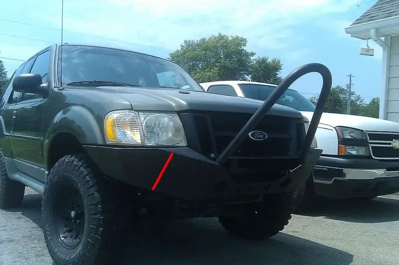

Would you be so kind as to tell me the width of this plate?
I have a lot of 6"x3/8"x16' steel plate. If the width of that plate is anywhere close, I'm getting closer to starting to build my own. I only ask because I think your dimensions look perfect. Do you mind if I copy your design? The only changes I can see making for mine would be that I don't have a stinger on hand and I'd just do a straight plate across the front, leaving enough room for a winch in the future.
I just don't have the balls to cut off my front fascia without having a solid plan in place. If your dimensions are close to what I can build with on hand stuff, I'm getting a lot closer and my balls will drop a little more.
I will take a look for you either tonight or tomorrow. If I remember correctly though I'd say that it is wider than 6". When I first built this I ordered a 2'x4' sheet of 3/16" I believe and cut my pieces out of that. I don't mind you copying the design. I may even be able to measure out the pieces for your own templates. I would recommend though from my experience, leave more room up front for the winch. I was able to get mine mounted, but it was tight and had to do a little cutting to get it to fit. It would just be easier on yourself if you didnt make it so tight up front.
I was figuring that piece is probably about 10". All great information. A template would be awesome but I wouldn't request that kind of effort. My father in law has a winch that I could use in the mock up, so I should be able to adjust accordingly. Thanks!:salute:

I grabbed that dimension at lunch today and you were pretty freaking close. I measured right around 9-1/2".

Great! Thanks. I think I can use the 6" pieces I have and do a 3" fold under at the bottom with a slight angle and work that around through the front. Time to get out the cardboard. Probably just going to remove the front fascia first and trace a grill sized piece of cardboard to work around. If my imagination excites me, I may start cutting.

thats the best looking aftermarket/homebuilt bumper ive seen for that front end. looks awesome man
Thanks. I guess I never showed much of when I added joint so that the stinger could be removed. There has been some debate about whether or not it is legal/not legal to have it while on the street. So this just makes it easy if you get pulled over to just take it off and be done with it.
