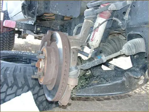

I think there will be interest since people will see that people like me break CV joints from running a non-selectable locker like the Powertrax.
The Big Dawgs out at Truckhaven were witness to my outer CV joint on the passenger side breaking when I was going up the Waterfall hill.
Of course, I think your biggest market would be with the Ranger 4x4 owners. Cuz I would think more of the Ranger 4x4 owners take their trucks offroad than do owners of Explorer 4x4's.

I remember the sound your axle made when it grenaded at waterfall hill. Sounded like a really big socket wrench spinning back.
