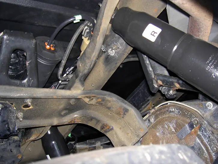

I added the Ford rear axle damper brackets, and installed Bilstein shocks at the
front and at the rear axle damper. The rear axle shocks are the auto adjusting
air shocks so I left them "as is".
