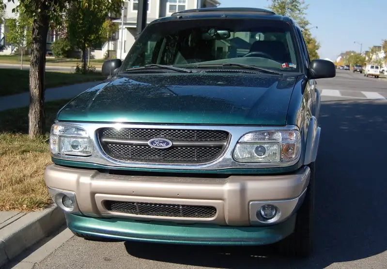

Black headlights and corner lights - $115
(projector)Morimoto Mini H1 - $120
Ballast - still have my old Morimoto's from before my wreck
(bulb) Morimoto H1 5000K - $40
Wiring Harness - $35
The Retrofit Source also sells complete kits with everything needed minus housings for retrofit
I did a retrofit on my '99. Results were great. I'm in Canada (Calgary). Never had an issue with cops.

The beam quality is the best I've ever had on my truck. Not half moon like those eBay all in one projector headlights. The cutoff isn't as nice as high end vehicles that come with HID as standard, but very, very good. I know of others who have done this mod and feel the same way.
I have never been flashed in the 2+ years since I put them in.

High beam is mechanical and works flawlessly. They do have a RHD version as well. You get them here.
