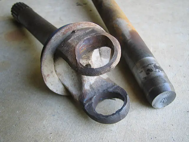

I've gone through I think four of these snapped D44 shafts and elongated or snapped yoke "ears":
Saying that an axle can stand up to 38's doesnt really mean anything because the other important factor is how heavy the vehicle is -- this weight, after all, is the opposing force of torque (from the engine) and therefore, it is the combination of torque (a function of tire diameter) and vehicle weight that will determine how long an axle will last. For example, a Dana 44 with 38's will probably last a year or two on a lightweight Suzuki Samurai but it won't last very long on a 4-dr Explorer.

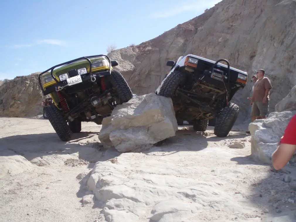

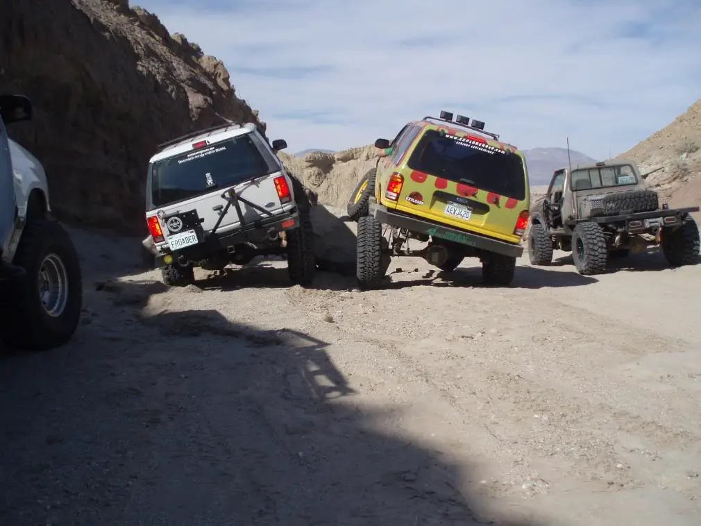

Jurrasic Park - FW with 37" MTRs
White - Narrowed with 36" SXs which are the same size as the MTR. With different backspacing on the wheels, the white one is as wide as the other.
thanks guys. those pictures answered everything!
