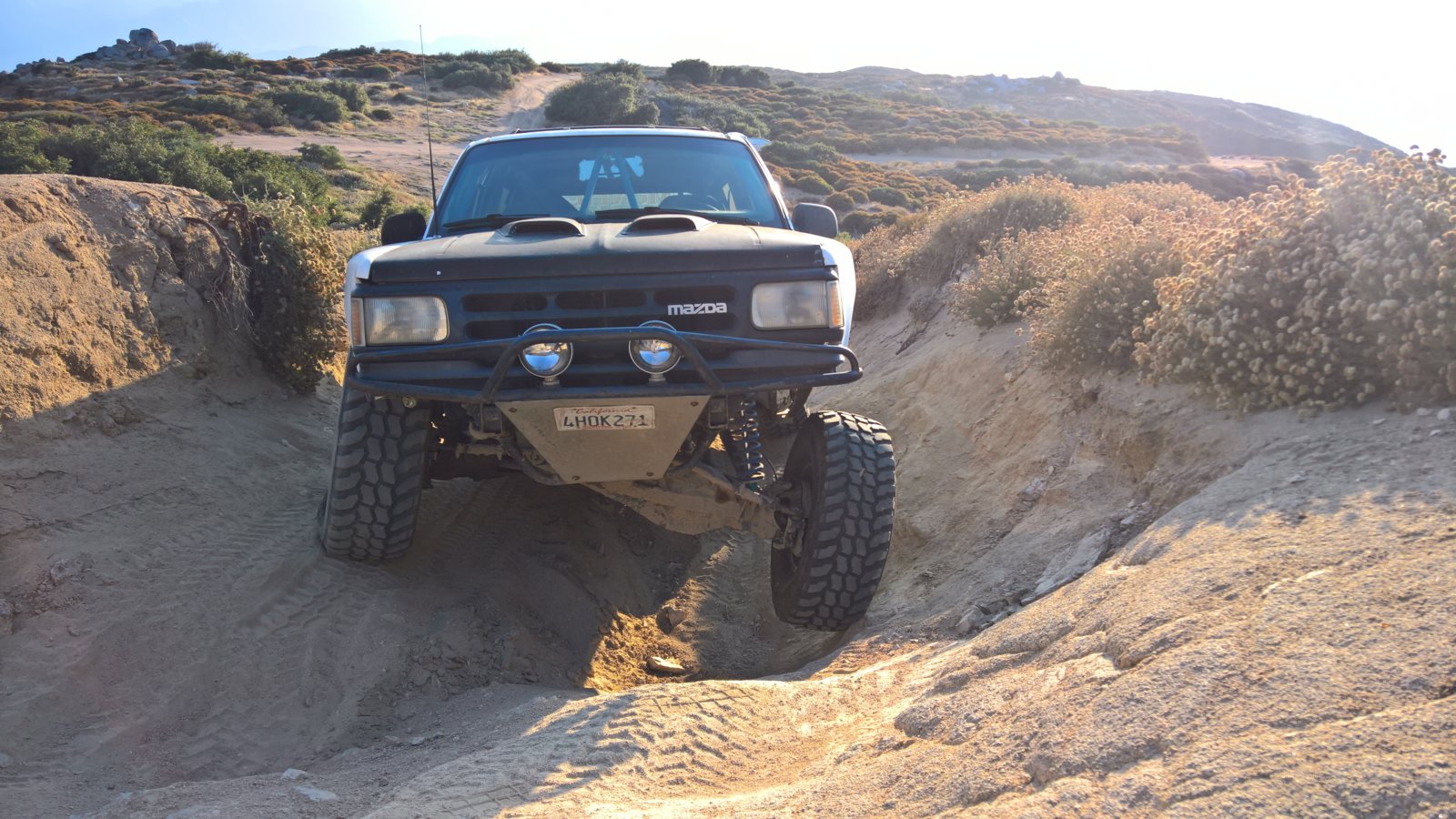

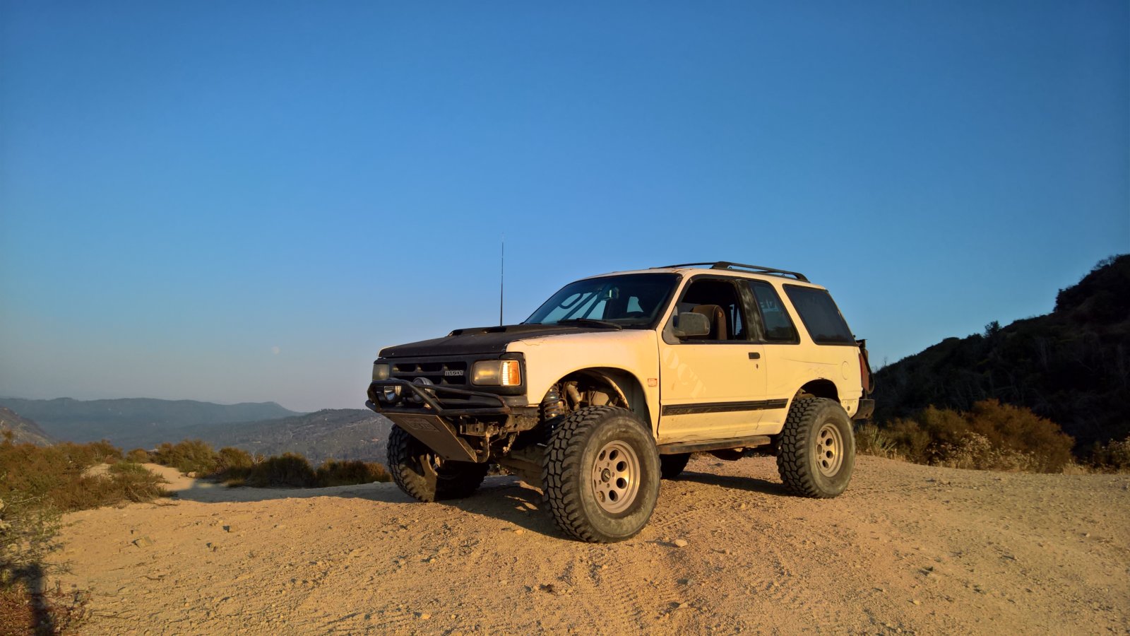

Since photobucket decided it wants to be the worst photo hosting site possible, I'll upload some pictures from today.
Yet another impromptu run through cleghorn.
Gonna try to go to the Rubicon trail with this next month. Thinking about it is what inspired me to take out this afternoon.

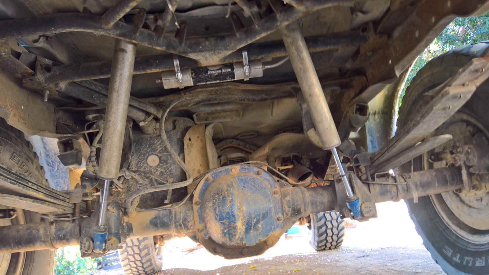

changed the shocks in the rear. Noticeably better. They're a little short for my setup, but work good. So I'll have to change the mounts to suit the length better.
