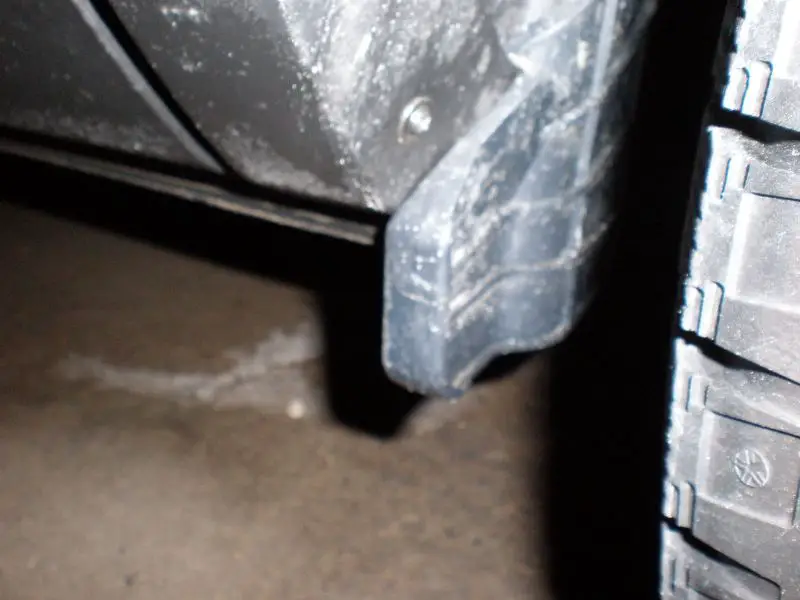

This is an old post but I just bought a used 2011 explorer and am having the same issue with the mud flaps flapping. If anyone can tell me how to pop the pins back in I would greatly appreciate it!!!

Are you also referring to the small piece that is mounted in front of the rear wheel? If so, that is not a mud flap. Like the front lower air dam, this piece is part of the vehicle's aerodynamics. I'm not sure if they are just push pins as they seem to have a slot in the head. If you can't get them in, I suppose screws would do the job.
