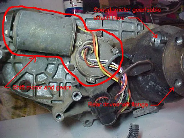

This is a general how-to thread for fixing the transfer case shift motor for the 4X4 models. Many posts on this site have been great sources of information, but pictures are worth thousands of words. I wanted to put something up for people to point others to when they have 4X4 problems. So here am going to list some key words to help the searchers:
Transfer Case Electric Shift Motor 4X4 4x4 4WD 4wd 4X Borg Warner 13-54 BW1354 BW13-54
First thing is where is that 4X4 shift motor? You have to crawl underneath and look at the back of the transfer case (which is behind the transmission). Looking at it from behind it will look something like this:
It has been said that tapping or hitting the shift motor will sometimes get it to engage if it is stuck in a position. This may work (it's probably worth a try), but don'tt hit it too hard or you might be looking at $300 to get a replacement.
To straight out replace the motor with an OEM or aftermarket one, eight bolts are all that is needed to remove the motor. Four bolts hold on the weight that is used as a vibration dampener (not shown, but locations are marked in blue), and four bolts hold on the shift motor (locations marked in red are 10mm). Two of these bolts attach a bracket that secures the electrical connector as well as holding a sensor in place (it has an o-ring and just needs to be kept from popping out of the case). There is silicone sealant used between the shift motor and the t-case body, so a little gentle prying might be in order (and don'tt forget to seal it back up and make it weatherproof when you are replacing it).
