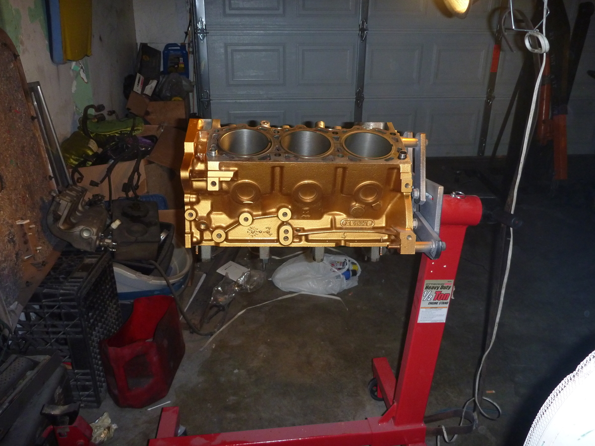

Recently bought a 92 Eddie Bauer and a 94 Limited. Both automatics with elec-4x4s. Pulled the engine of the Eddie and tore it down to rebuild and put into my 92 XLT. My friends and I have been deburring and porting the heads and block. Also honed the cylinders and are currently working on cross-hatching them. Waiting on parts and gaskets to arrive. Planning on gasket matching everything. We are also gonna remove the front axles to convert mine to 4wd. The only thing I would prefer to have is a m-t case instead of the electronic one i currently have. Does anyone know were I can get one or someone willing to trade?
