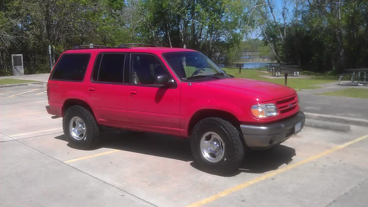

Id like to point out how far along this Explorer has come. Back on 12/10/06 I bought this Explorer from a Towing company with a storage lien. This is what it looked like when I got it home.
:eek:
Very impressive!
Kris did some great work on it for sure. I'm glad I could be able to make it even better. :)
NO doubt, Kris does excellent work!!!
