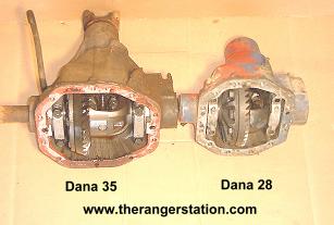

Yup, that "center section" is referred to as the "3rd member," "pig," or "pumpkin" depending on what neck of the woods you live in...
Here is a Dana 35 TTB vs. a Dana 28 TTB 3rd member, make sure you get the right one.
So i found a 88 Ranger 4x4 4 cyl for sale pretty cheap. How do I know if it is Dana 28 or 35. Do I just have to measure or is there a way to tell on the truck. Thanks
An 88 should have a Dana 28 -- the 35 didnt appear in the Ranger scene until 2 years later.
