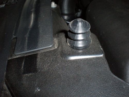

There is a hood switch on the drivers side.
What is the hood pin in the IDS??

It's on the left side of the engine compartment. I think we've narrowed down that XLT and above all come with a hood switch. Go to forscan site and download. Get an OBDLink MX Bluetooth from scantool.net

See this link for a picture of the switch; http://www.explorerforum.com/forums...cts-2011-2015-only.418625/page-3#post-3393082
The picture shows it as it looks in the Lincoln I had but it is the same for the Explorer.
